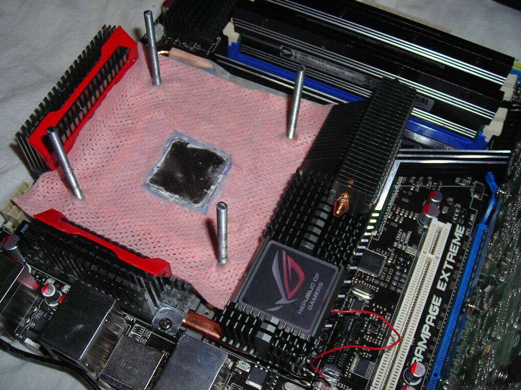

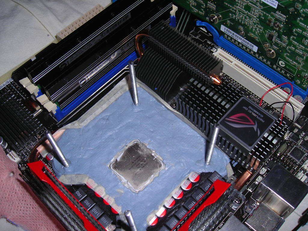

heres mine before solid shows you his ( lol that sounded dirty ) :D
Asus rampage extreme
http://i163.photobucket.com/albums/t...s/DSCN1338.jpg
http://i163.photobucket.com/albums/t...s/DSCN1340.jpg
Nice Solar mate :up: did your run go ok ?
it worked great for me dinos. you will just have to put something to on top of the bluetac insulation layer to absorb the condensation, for me it sweated alot the first time i tested that method.
yep perfectly :D that stuff is little bit tougher to get off than the kneeted rubber but still very officiant in keeping the nasty condensation away from your precious board with some help of dishcloth or something similar to keep the bluetac from sweating witch it does to some extend (at least with me ) :up:

Some more pics :D
http://img.photobucket.com/albums/v2...P/IMG_5173.jpg
http://img.photobucket.com/albums/v2...P/IMG_5178.jpg
http://img.photobucket.com/albums/v2...P/IMG_5195.jpg
http://img.photobucket.com/albums/v2...P/IMG_5200.jpg
http://img.photobucket.com/albums/v2...P/IMG_5211.jpg
http://img.photobucket.com/albums/v2...P/IMG_5218.jpg
http://img.photobucket.com/albums/v2...P/IMG_5223.jpg
good luck with your bench
i plan to do the same soon
Thanks mate im looking forward to your results already. Now all i need is time to do the actual benching :D

bluetac sweats like a pig and solarfall was saying he uses a layer of something
i just asked to see what you guys do
i will do the same and see what happens
thing is i use fans all over the place here too
eraser is MUCH better than bluetac
