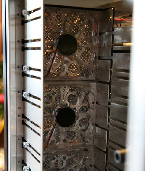

The PCP&C 1kw will fit with a PA120.3 mounted but will leave no room for the PSU cables and running tubes to the rad. The Ultra X3 is 19cm in lenght and there are 2 things that helped with the clearance between the psu and the rad. (1) X3 modular cables are thin and flexible. I managed to tuck some of the cables underneath the psu. (2) I had to cut both the top and bottom fan shrouds from the LL343B Fan Module so that the PA120.3 can be mounted further toward the front, providing about another 1.5" of clearance.
Cut along red line to top (shown) and bottom of this fan module. Result is image on the right.
http://i211.photobucket.com/albums/b...NMODULE_01.jpg http://i211.photobucket.com/albums/b...55_Cropped.jpg
With your 22cm psu, it should fit with a PA120.3 push+pull config. provided you mod the 3x5.25 Fan Module by cutting the shrouds. OR, get this bay module instead:
http://www.performance-pcs.com/catal...oducts_id=3704
One more additional option is to mount the rad with barbs at the top if there's not enough clearance to run tubes at the bottom.
