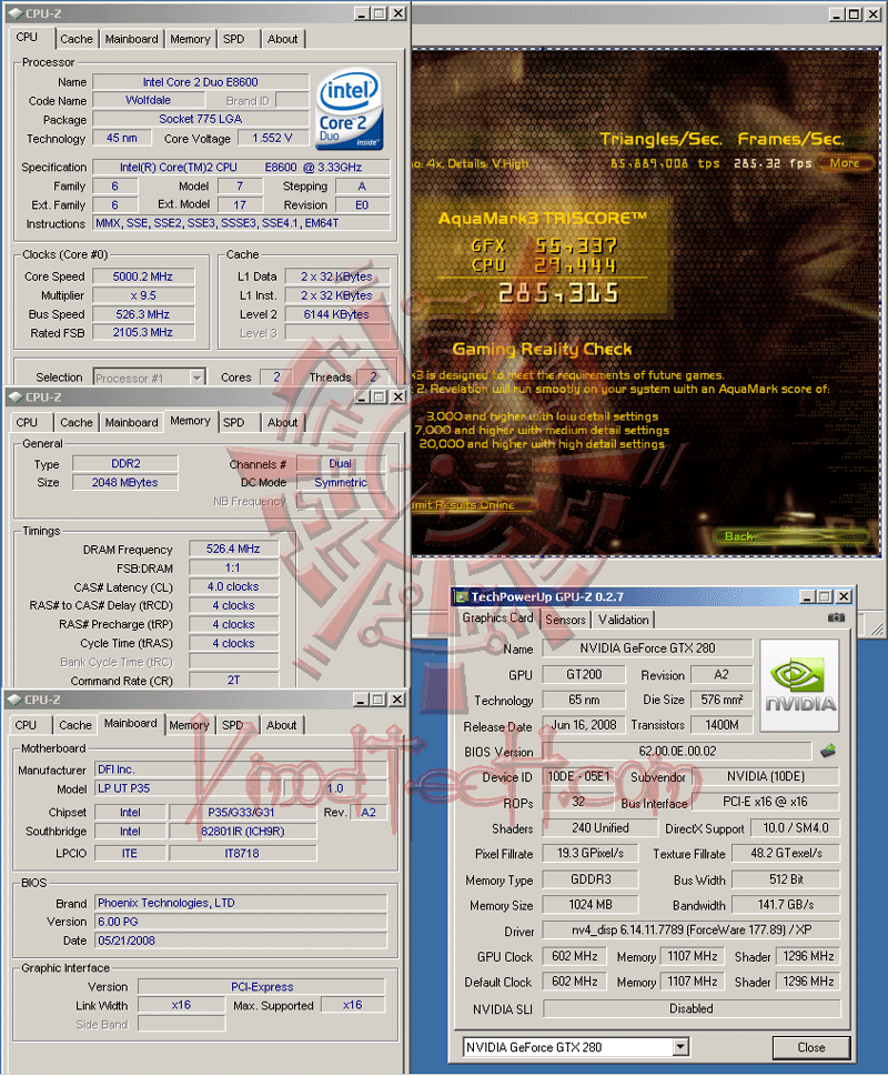

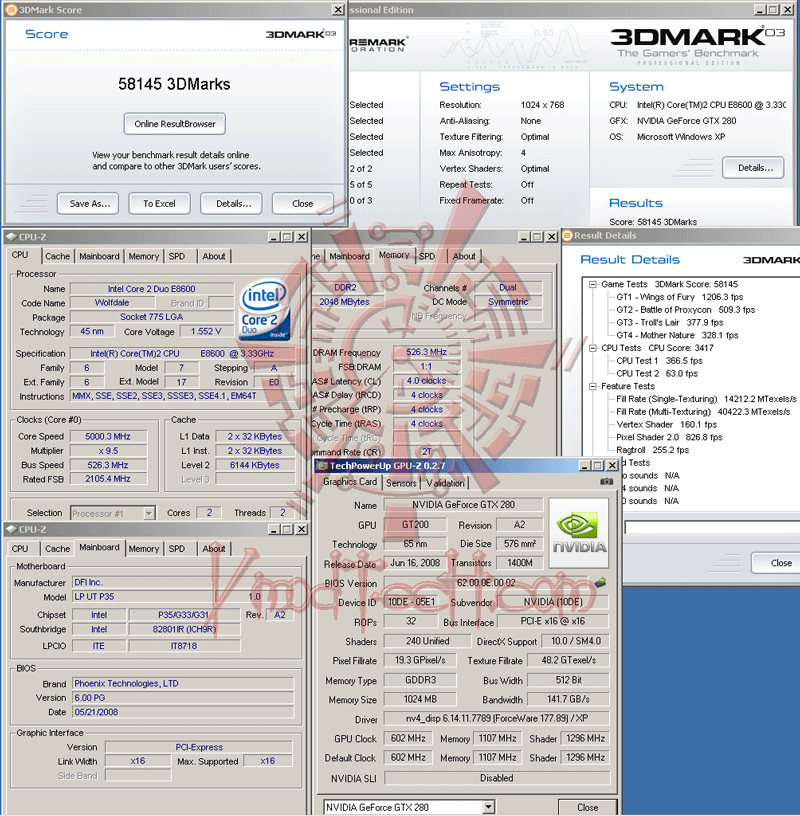

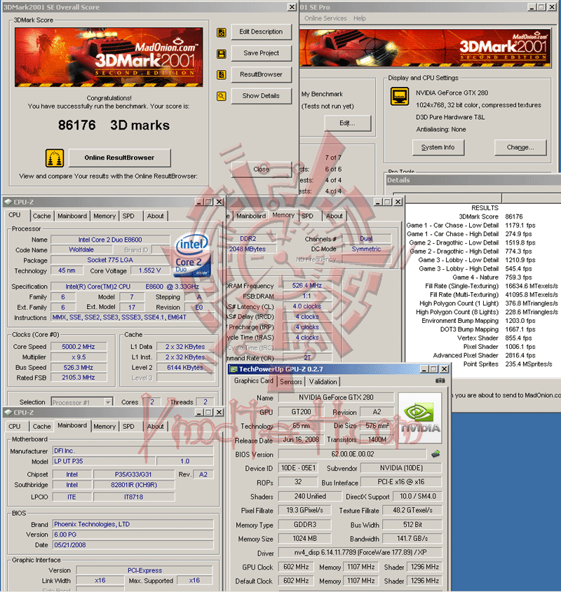

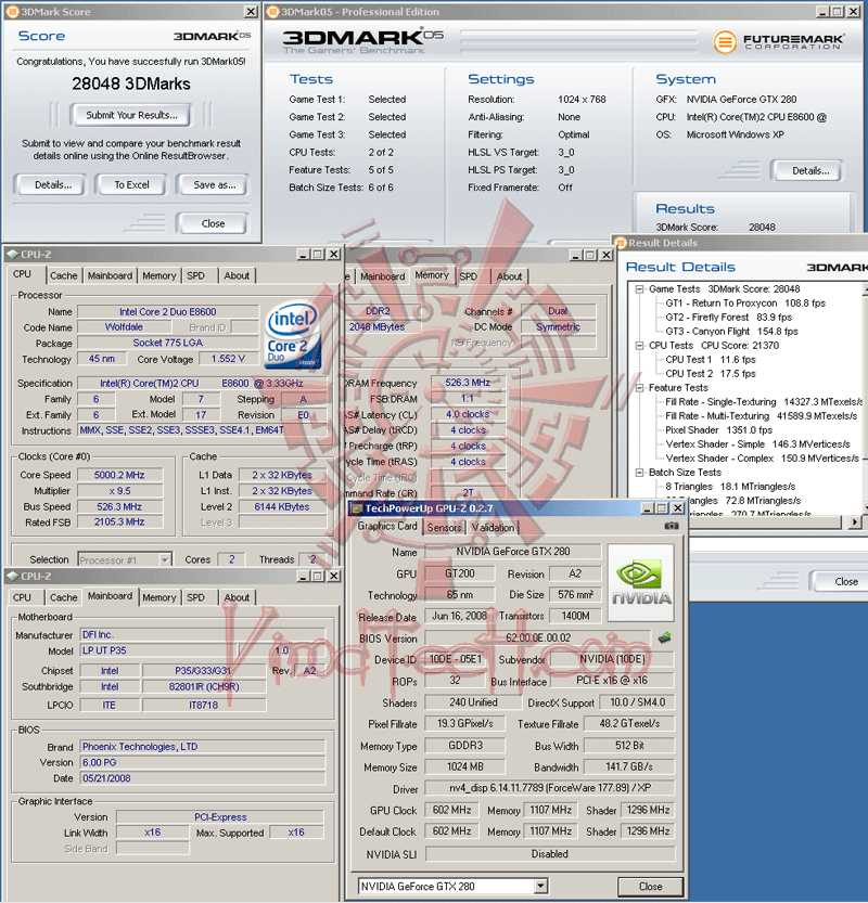

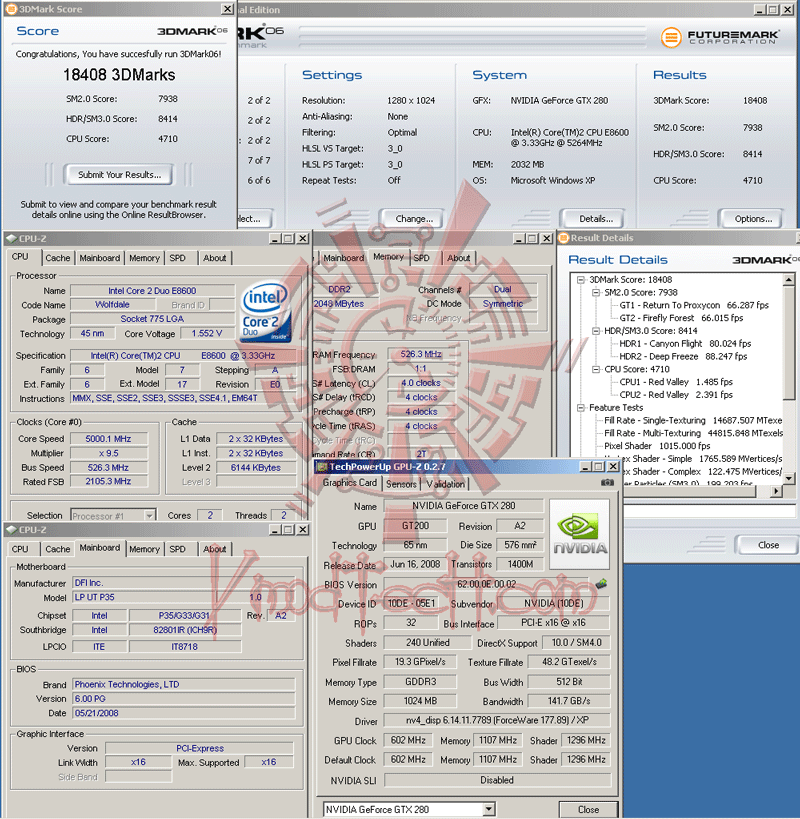

my result with e8600 & Stock GTX280 on regular water cooling;)
http://www.vmodtech.com/spaw/images/...000-280gig.png
