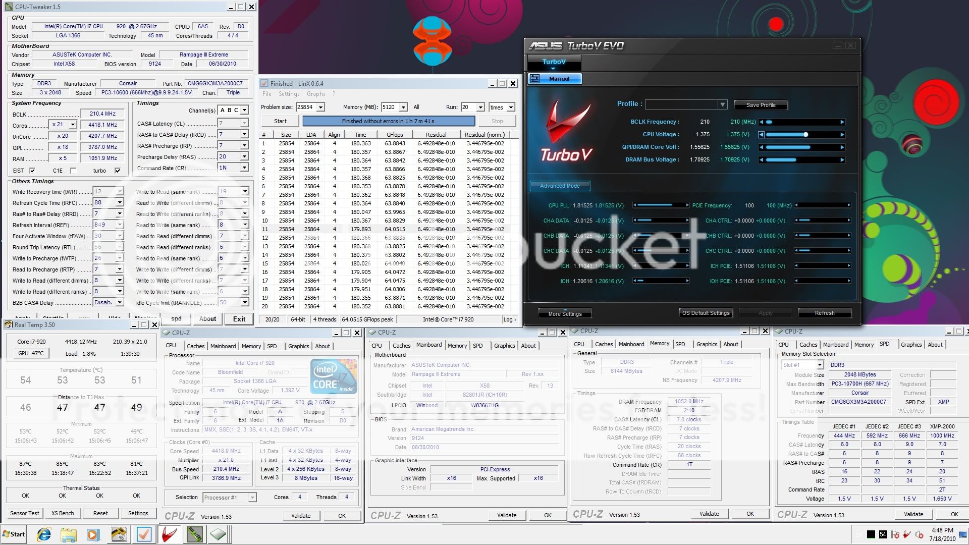

Initial test on core 4.4Ghz, uncore 4.2Ghz, dram 2100Mhz 7-7-7-20-1T
http://i458.photobucket.com/albums/q...ikh84/44-1.jpg
GFlops a lil bit lower than expected, need to bump up some voltages so that vCore, vtt, and vdimm can be reduced.

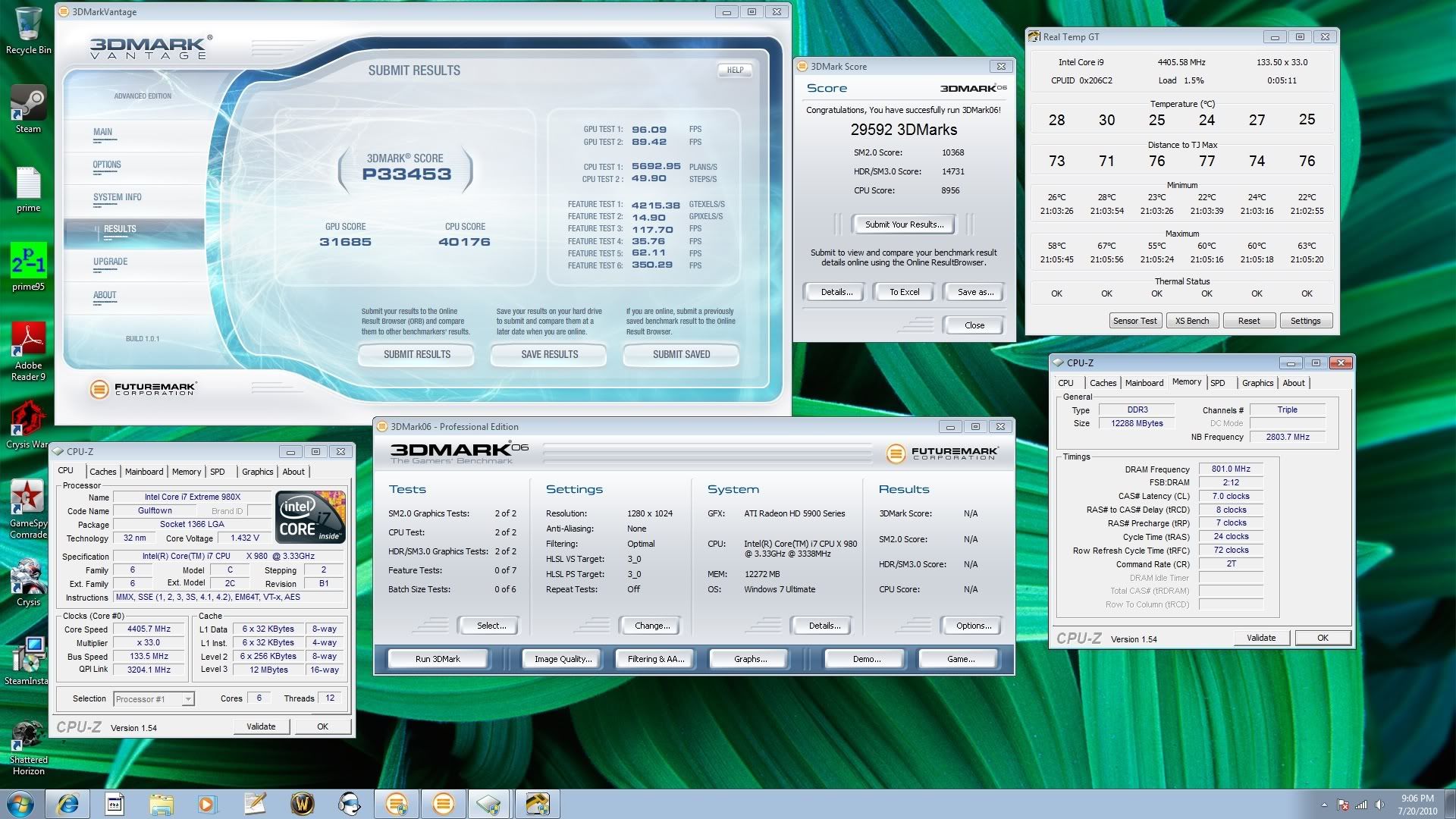

on another note... here's my offering with the 980x on water:
oddly enough both bench marks are set to the same standard startup settings yet Vantage seems to always score higher than 06 bench for me for some reason... i dunno. at the same time, with 06, no matter what settings i put it to it ALWAYS gets roughly the same score with a difference of only around 150-250 points each time...
only thing limiting me now is my memory, but the 12gb 1866 Dominator-GT pack coming in a few days will fix that right up :P
system:
CPU - 980x @ 4.4ghz 1.38v, not 1.45v as CPUz states
Mem - G.Skill ECO's @ 12gb 1600mhz 7-8-7-24-72 2T timings w/ 1.62v
GPU - HD5970 @ 950core / 1253memory
sorry for image size, i can't seem to make it smaller without making it unreadable...
http://i3.photobucket.com/albums/y71...mybench2-1.jpg

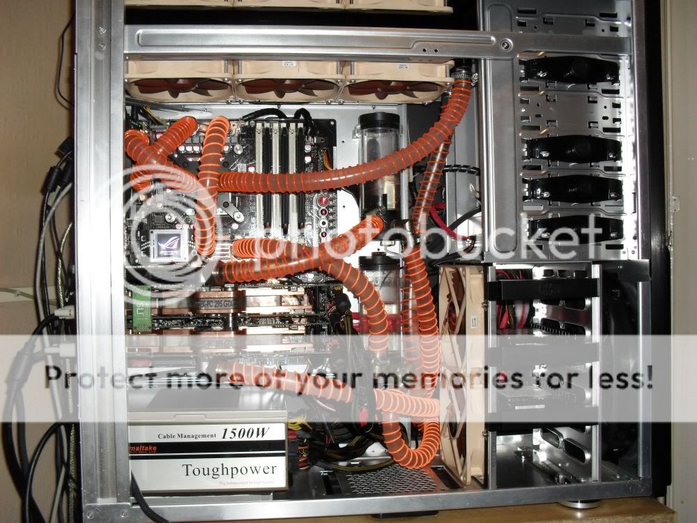

http://i696.photobucket.com/albums/v...igmarch4th.jpg
but when fermi came out and was such a disapointment compared to what we all where expecting I went to ati, Im now running 2 5870s on water and the difference is remarkable as quad sli does not scale to well in many games.
http://i696.photobucket.com/albums/v...ingleloop3.jpg
when fermi is as good as it should have been at launch I will buy it !!
