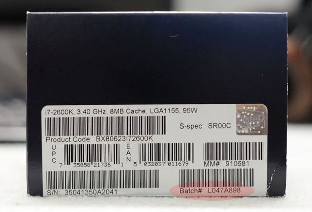

This week new batch apear here in Malaysia (KL) L047A898.
maxxx,hurry up!:D
http://i284.photobucket.com/albums/l...DSC_0028-1.jpg
Erm, overclockers here are already reselling their week 51 chips (L051) in SG after trying them out. :D
