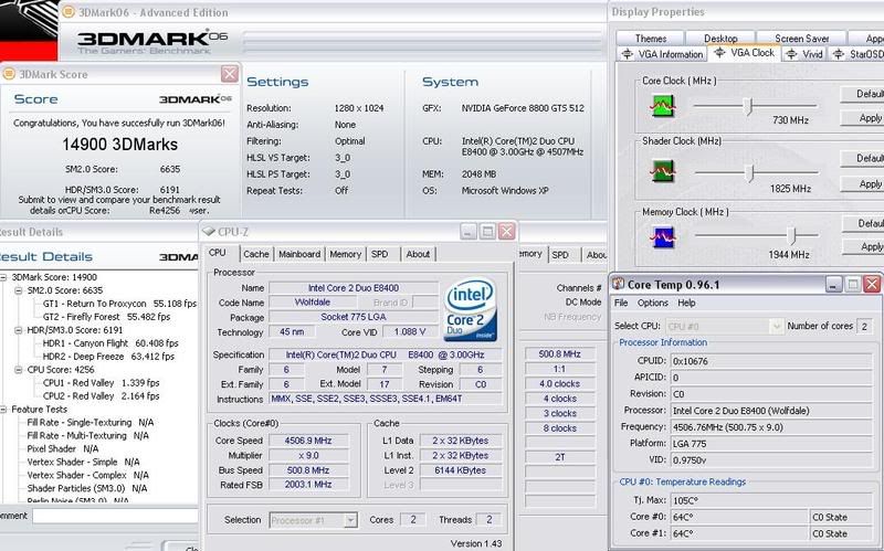

3D06 @ 501x9, gpu@stock :
http://i76.photobucket.com/albums/j3...3d06_stock.jpg

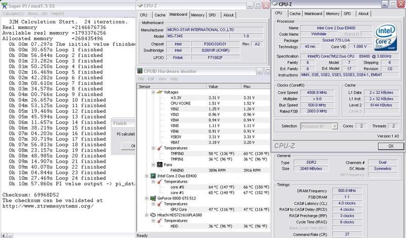

http://i76.photobucket.com/albums/j3..._nuclearus.jpg
Spi32m @ 1:1 :
http://i76.photobucket.com/albums/j3..._hwmonitor.jpg

Bump up gpu clocks abit...
then tried to clear 16k with higher cpu speed...
Have not login to ORB for a very long time...
took more than 10 tries to remember my email n password...
then managed to logged in... faintz...
Heres the compare link :
http://service.futuremark.com/compare?3dm06=5154609
http://i76.photobucket.com/albums/j3...0420252164.jpg
Kept vcore @ 1.55v...
514x9.... 515x9 no go....
i guess need cooler temps... too hot...

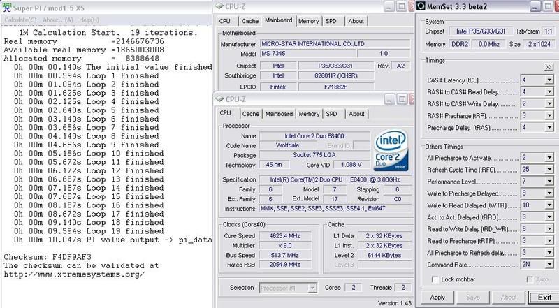

http://valid.x86-secret.com/show_oc.php?id=310620
http://i76.photobucket.com/albums/j3...spi1m_cpuz.jpg
