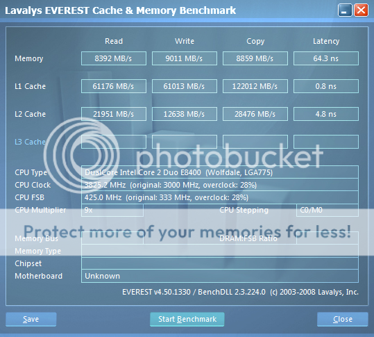

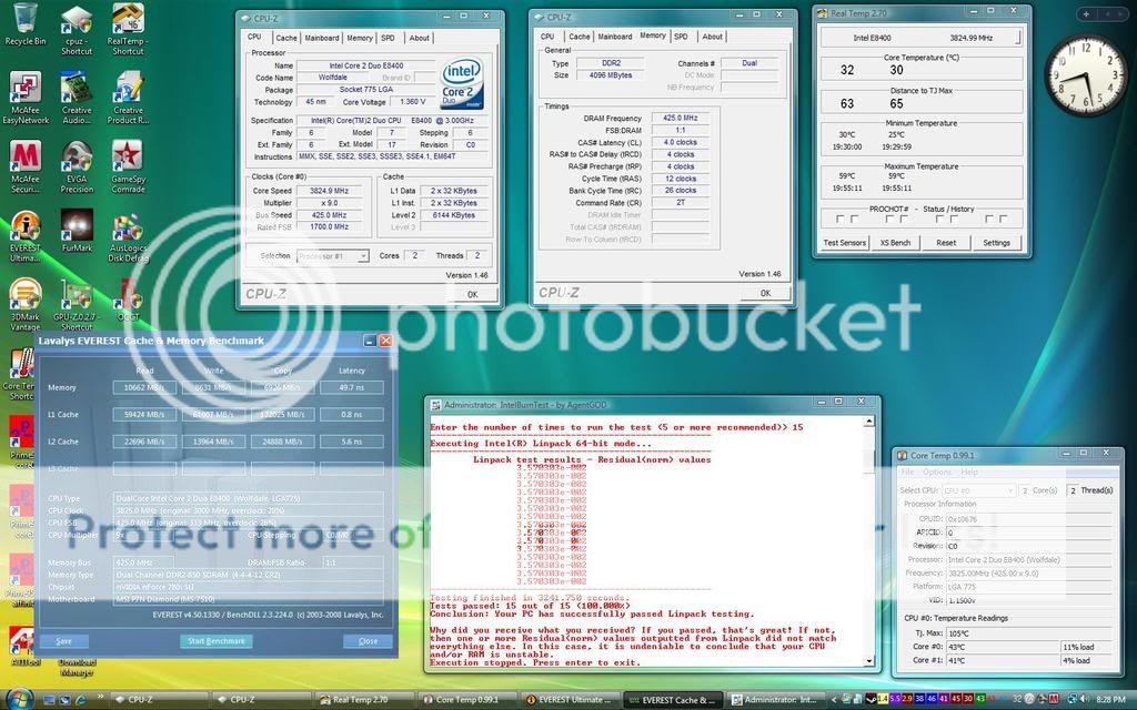

Some chips are better than others. Like me you may have gotten a bad batch. I have an e8400. The VID is 1.2250! On a 45nm chip. It also needs a high vtt for stability. I find it relly hard to get this chip stable at anything much higher than a 425fsbx9. Im sure that I can go to atleast 450 on the fsb but getting it stable isnt easy. I am having much better results than my last board at least. Does anyone have any tips on how I could run my ram at 1066, 4,4,4,12? Icant even get it to post at 4,4,4,12. It seems stable at 5,5,5,15 with 2.1v on the dimms and the NBv at auto, it passes 10 runs of Linpack.I still need to play around with the NBv. Im not very familliar with memory overclocking. At what voltage should I start to get nervous feeding my ram?
Forget about running 2gb stick at 1066Mhz at Cas4...
And NB at auto is a sign you didn't do ya homework before clocking this board... 1.26NB voltage is more than sufficient for 500FSB/1000mhz ops...secondly most of these board overvolts the ram with 0.08, so you are feeding ya reapers with 2.2volts which is not required at all, put in Trfc 55 and try to run static read control enabled... then try to mess with the PL's...
Not a problem, but....I've noticed when I reboot this board, I hear a very distinct power drop (doesn't cut off completely, I don't think), but the fans rpm drops off or a split second...is this normal for this board?
You are the man! Thanks for the advice. Static read control enabled causes my my board to fail to post and when I reboot I get a failed overclock message, so thats a no go. I haven't tried it yet on this board but I got better performance with the memory on my 780i at 850mhz 4-4-4-12 than I am getting now with 1066mhz at 5-5-5-15. I could aslo pull off a 1t command rate. Playing with the pls can help me out a little. http://i308.photobucket.com/albums/k.../Overclock.jpg http://i308.photobucket.com/albums/k...5-5-15auto.png
