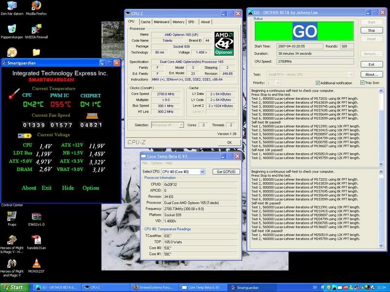

I can't get my Opteron 165 (CCBBE 0615DPMW) stable past 2835mhz on air. I had it running at 2885mhz for a LONG time, and it seemed stable, until I got a couple of blue screens while gaming. So I've since backed down to 2835. I'm not entirely sure what's holding me back.
I have a couple questions too, what does VID stand for? I'm assuming it is the stock vcore for a CPU? TCaseMax and TDP are also new to me... my VID is 1.35, TCaseMax is 57, and TDP is 75. I'm assuming from seeing other screenshots, these aren't very good.
Well, my board can run 350 HTT (or higher, I stopped there), so I'll pretty much never need to worry about that being a limiting factor. The ram is on a divider and I know it's stable. I'm thinking the ole Opty just needs more voltage. Maybe a +.1 in chipset too.
I have the same stepping as you! Got it upp and running today on my DFI Expert, Booted straight into win at 300*9 @ 1,4 running Orthos now. Does your cpu run as hot as mine? Cold by TT Big Typhoon. \\Regards BadNizze

It seems to run a bit warmer than my CCBBE0610 but is cooler as it is running 3060Mhz at the mo on 1.50v
whereas the CCBBE0610 needed 1.568v to do that.
At the mo running F@H on core 1 and F@H GPU the temps are Core 0 52 Deg C and Core 1 54 Deg C.
