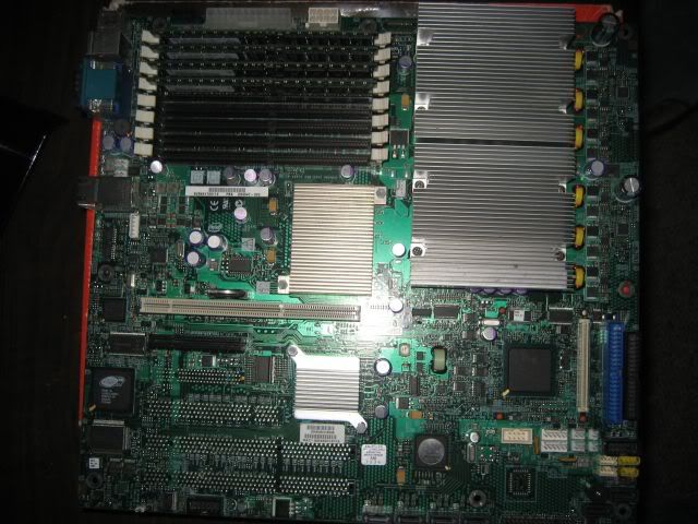

My Sossaman Set ( 150+ shipping) SOLD!!!!!!!!!
2 x 2.0ghz sossaman cpus
2 x intel heatsinks
2 x 1gb ram (100% working) + 2 x 512mb (might work)
1 x lian li backplate

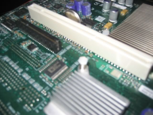

1 x intel se7520bb2 motherboard (modified the pci-e x8 slot to fit a pci-e x16 video card)
http://i31.photobucket.com/albums/c3...w/IMG_0043.jpg
http://i31.photobucket.com/albums/c3...w/IMG_0044.jpg
