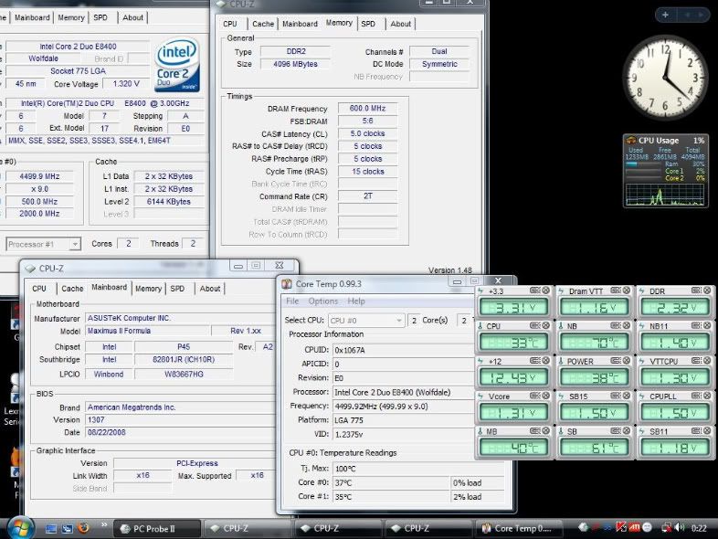

Can I use this Setting for the Q9650
This is my setting for the E8400 (Stable)
I will be getting the Q9650 soon
I would like to know if I can use the same setting or where to modify
