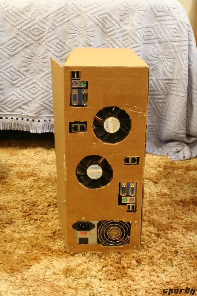

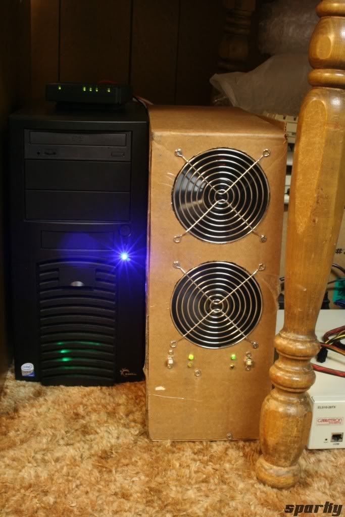

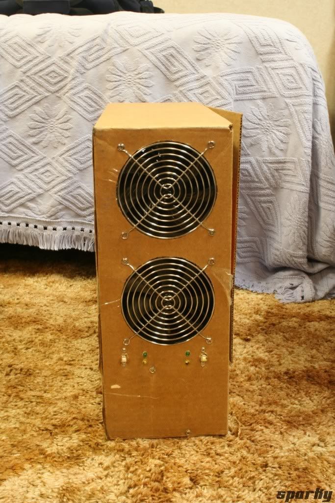

OK here are pics of my dual sammys on one PSU in one box :D PSU is a 400W antec and it barely even blows warmish air out :up:

@sparky
You use the box that came with your motherboard. Hahaha
Amazing, what a work of art. :D
SparkyJJO- You are my new hero! That's so cool. :rofl:
(I feel like I should be pushing up some glasses and adjusting suspenders...:rolleyes:)
