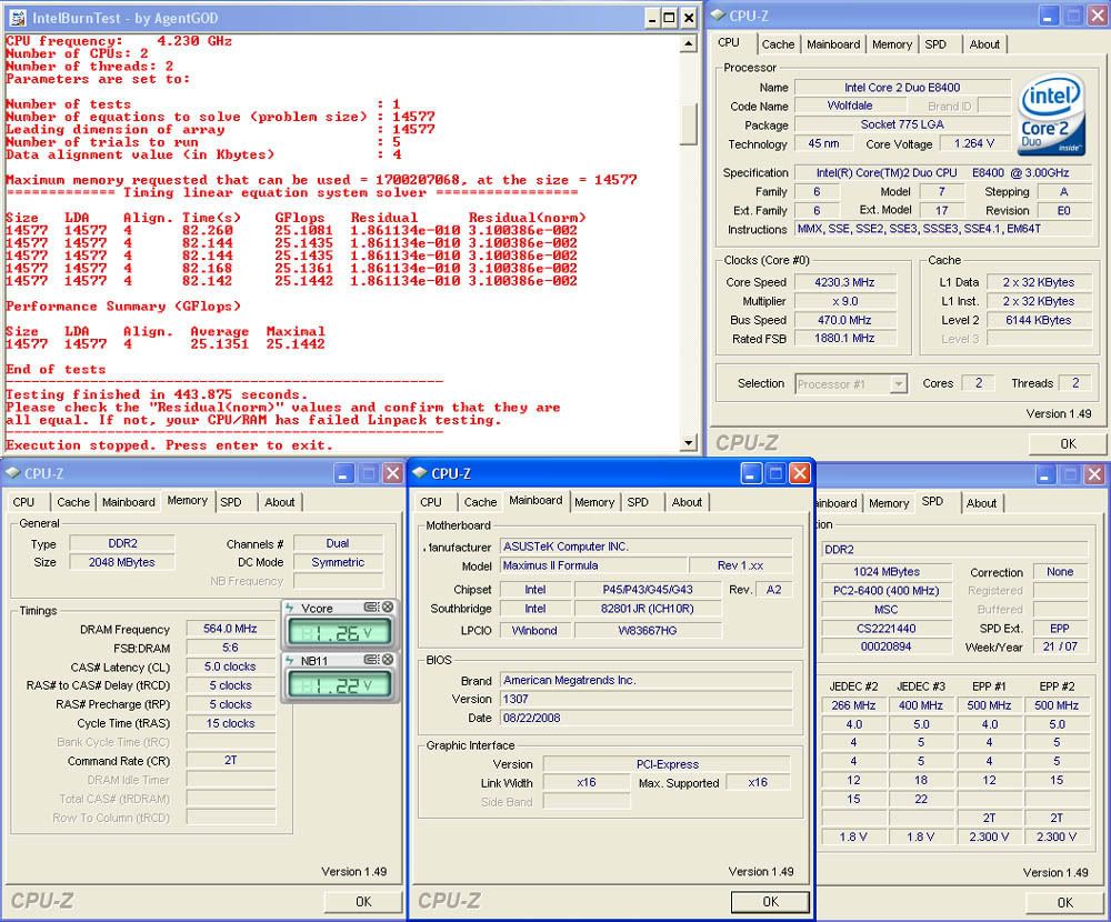

OK, I up'ed the FSB and Memory clock as u stated on thread #2823,pg113.
I found that FSB 460, multi 9, Dram freq 1105 became my best testing area.
@465, my temps in everest went crazy. Showing 255 on a few when I started prime.
Retested ALL NB GTL's again, however, I have 3 that made it to 9 mins.
[-40],[-60],and[-65].
Any suggestions on how to determind which would be best?

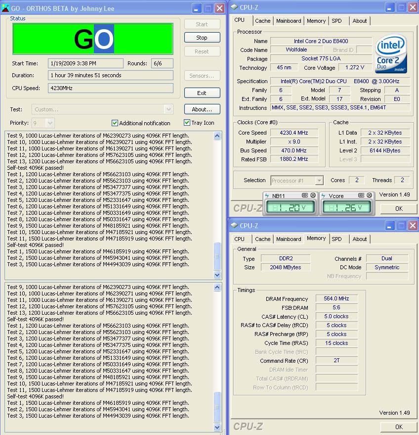

Did a bit more testing.
Orthos custom run 4096K
vcore 1.263/1.268 - 1.272 (idle/load)
vNB 1.20v
PL8
http://i266.photobucket.com/albums/i...NB120vgtlr.jpg
When I ran linpack it was not quite stable so increased vNB one notch, which gave me stability.
http://i266.photobucket.com/albums/i...0vgtlref-6.jpg
Good looking chip you have there, what kinda temps are you hitting on load?
Last low volt chip I had produced alot of heat.
It is a good thing that all the best values you found for your GTL NB, are close to each other. [-40],[-60],and[-65].
I have run into that problem when I have tunned my GTL's too. You can try to put more stress on the system, to see if a single value of NB GTL will come out. You can do that by raising the FSB a bit and the mem clock, and testing the 3 values again. Or, you can just keep those 3 values for you, and randomly pic one. When you finish the guide, and have you tunning completed, then you can try to push the system harder, and again, test those 3 NB GTL's. Maybe after all the other settings are tunned, there will be a single best NB GTL value. I have done the second option. For me, NB GTL of +20mV and +30mV were the same. So I moved one, picking 30mV, and till these day, I couldn't find a difference between +20mV and +30mV for me.
Hope it helps.
[]'s
Simps
Looking good CryptiK.
Here is what I have found it is best and takes less time to test a system for full stability.
I found out that you only need to run IBT and PRIME BLEND.
I start with IBT 20 loops on max stress. If it don't pass it, then I don't even bother with PRIME. If it passes, then I go for prime blend for 4 hours.
If it passes, its done.
I have never had a single setting that passed 20 loops IBT on max stress, and 4hours prime blend to crash on me. All the other stress programs like OCCT, PRIME SMALL FFT's, memtest, etc, will pass too.
[]'s
Simps
Thanks. It's around 58*C in IBT with a lapped TRUE, MX-2 and 54cfm fan. This was in ~20*C ambients, so it will get even hotter on a warm day.
I was just testing a theory so I ran the tests in that order on purpose. I find that 4096K test is harder on ram/NB than blend/large FFT's are, and I was specifically trying to load the ram/nb during those tests.
