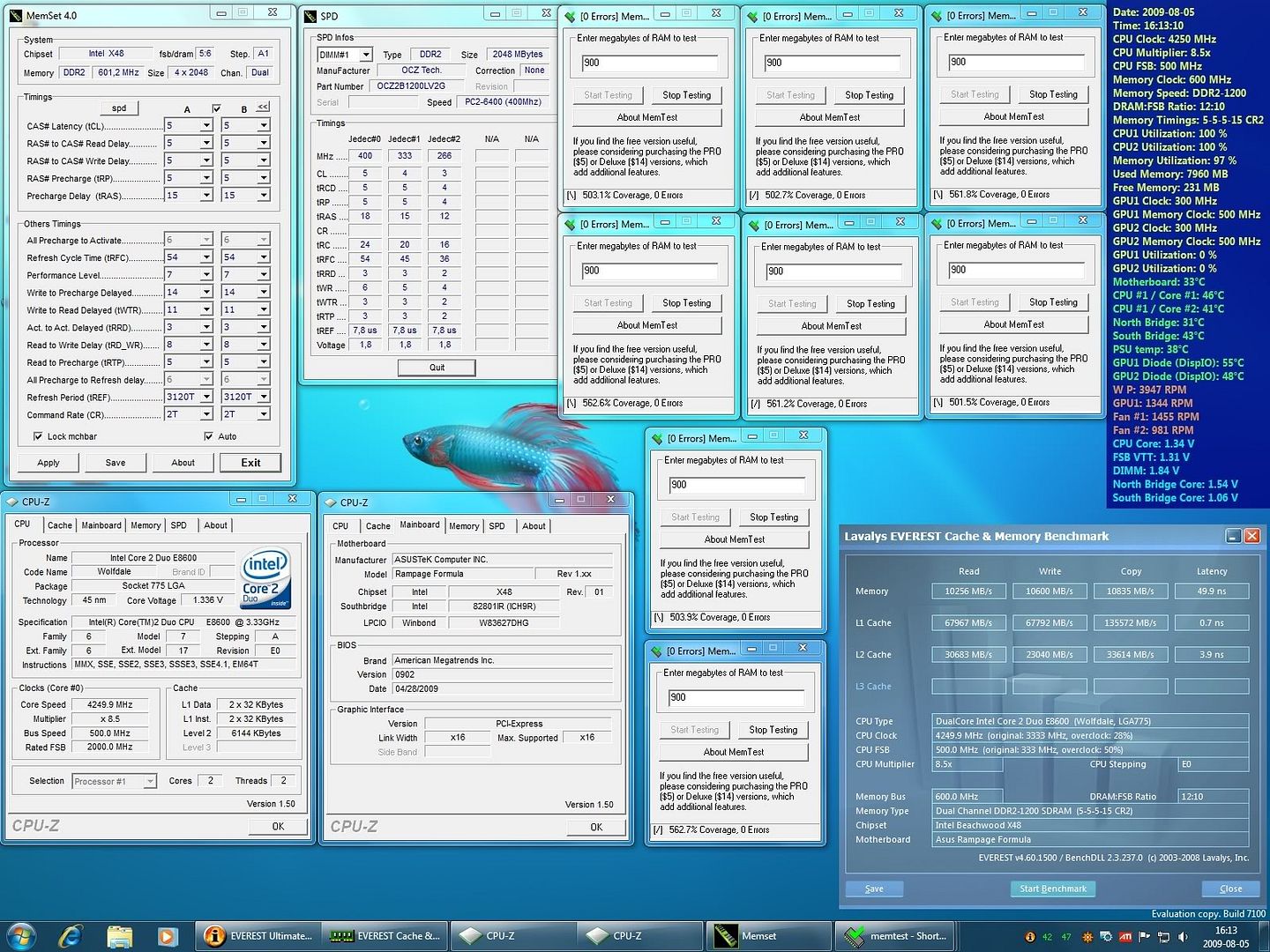

Hereīs some screenies with my E8600@500 4,25GHz and 4x2 OCZ Blade PC-9600@1200 555 15 tRD7 Strong.

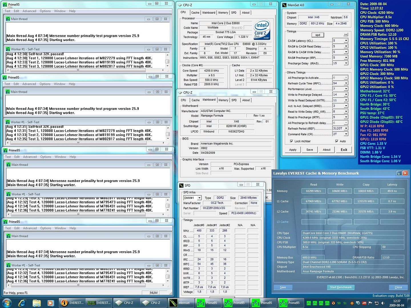

~5 hrs P95 blend (4x1600mb)

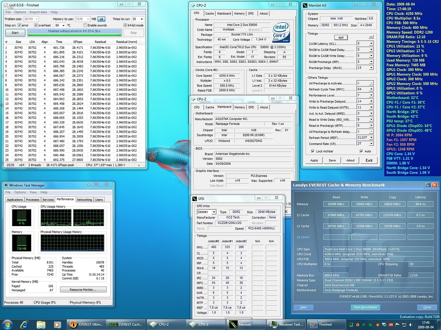

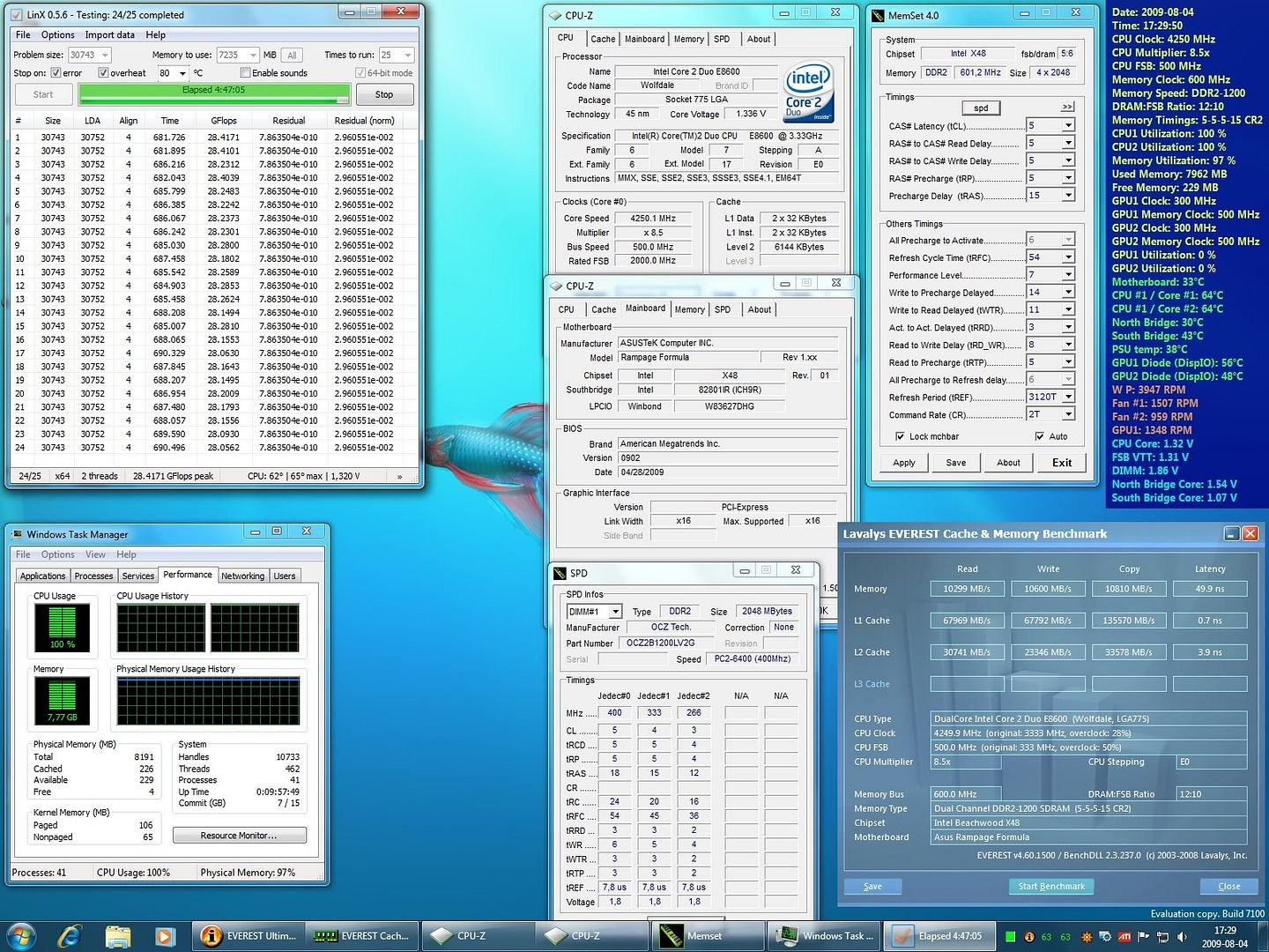

~5 hrs LinX (25 loop, max problem size and max memory use)
~5 hrs HCI Design Memtest (~500% with 8x900mb)

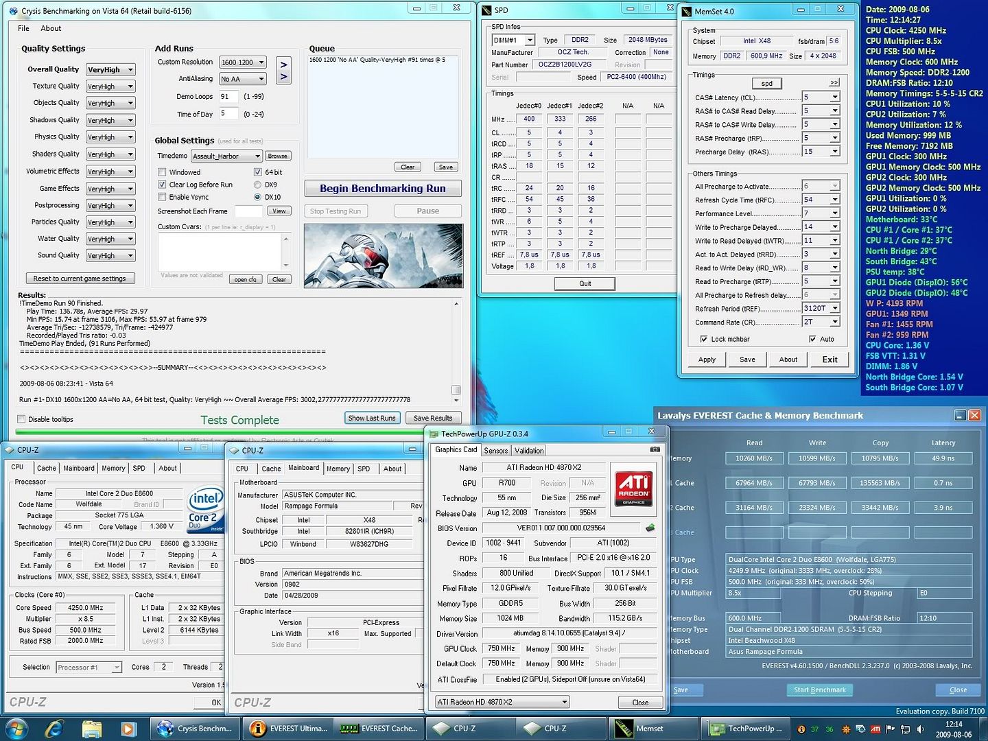

~3,5 hrs Crysis Benchmark Tool Assualt Harbor 90 loop
Stable enough for my.

Oh yes, she made it through all 25
http://i282.photobucket.com/albums/k...tRD7Stro-1.jpg
http://i282.photobucket.com/albums/k...tRD7Stro-3.jpg
http://i282.photobucket.com/albums/k...tRD7Stro-4.jpg
