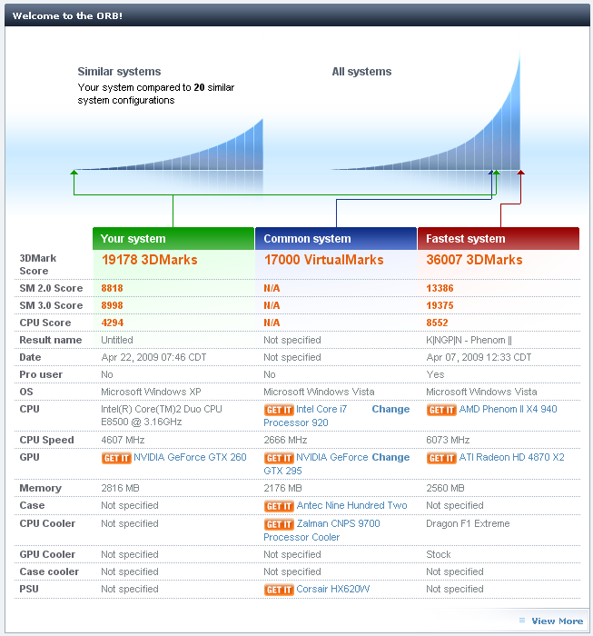

Here's an interesting comparison - E8500 @ 4.6GHz vs Q9550 @ 3.8GHz 3DMark06
Could go higher with the Q9550 but I'm selling it to a mate so 1.36v is plenty for benching
GTX 260 (216) is at 700/1500/2300 in both tests...
http://i293.photobucket.com/albums/m...ark06final.png
http://i293.photobucket.com/albums/m...k063800MHz.png
Yeap Quad Is Good For 3D 06 And Not Good For 3D 01 :D
