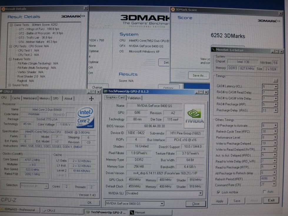

My very first run so far:
http://img.photobucket.com/albums/v310/T_M/Picture1.jpg
donno how much CPU will affect these runs but i'm thinking of whipping out one of these Sony laptops again and go for gold
8.4K from previous session wasn't too shabby :D:D:D
