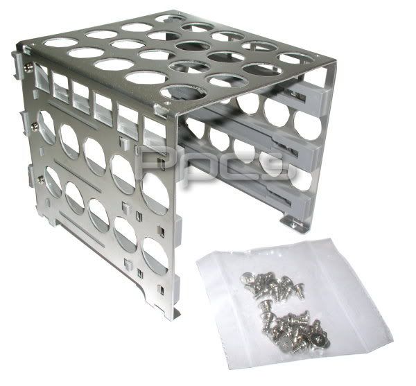

Hey guys I am missing some HDD screws for my V2000B... Are these scews common or I will have to order them from a special store?
It would be great if I could go to Home Hardware and find some :D

The 5 1/4 drive screws are the same as most computers but the 3 1/2" bay drive screws have a barrel mid section that slides in the runners and locking mechanism.
That's covered in the manual, you should have. But here's a copy if you don't have it. V2000 manual

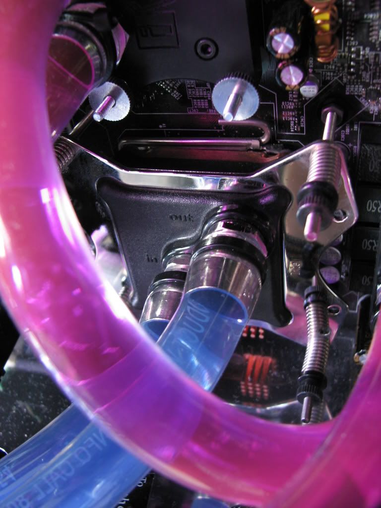

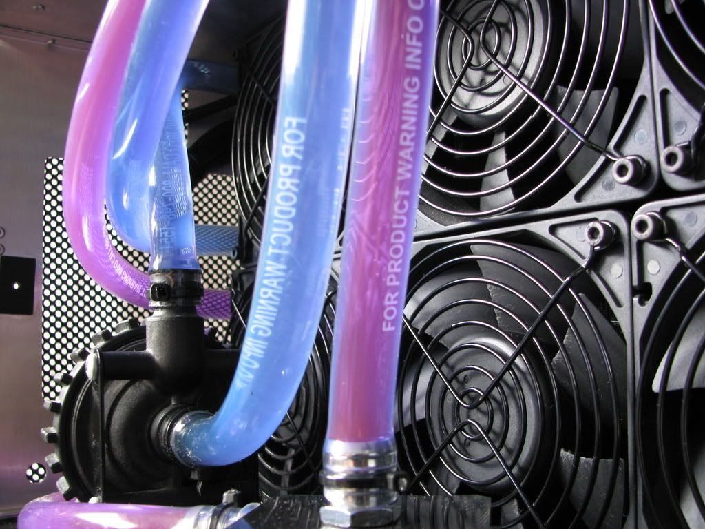

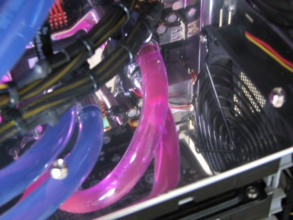

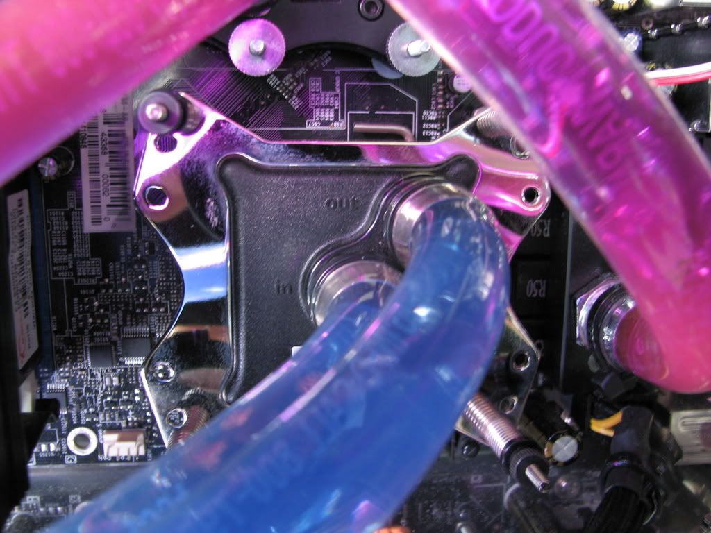

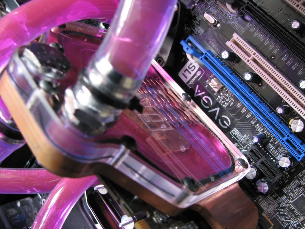

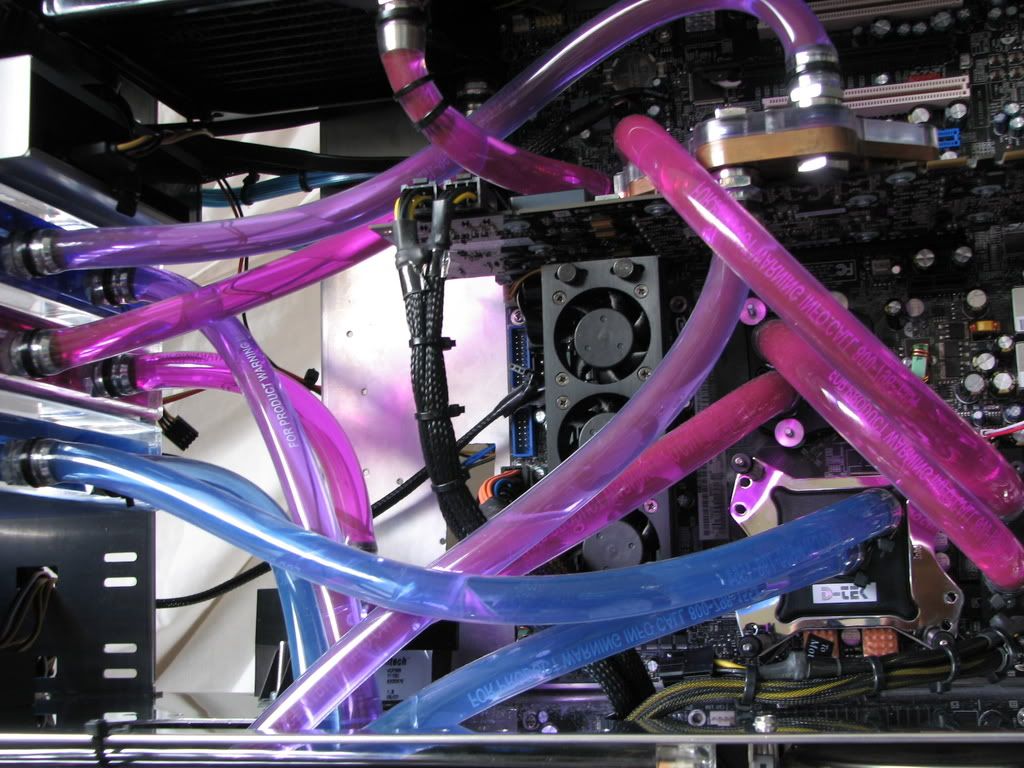

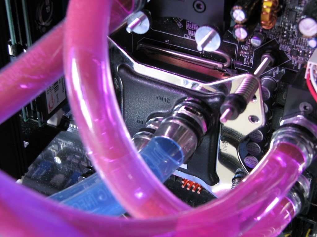

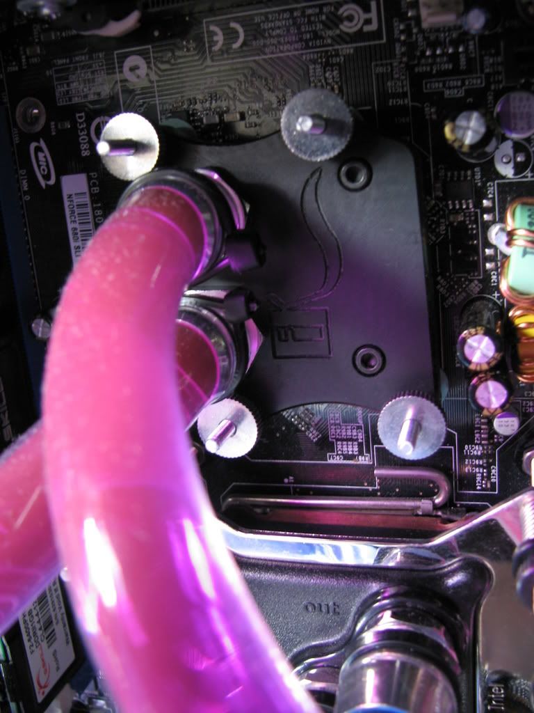

http://i212.photobucket.com/albums/c...dpcpics041.jpg
http://i212.photobucket.com/albums/c...dpcpics047.jpg
http://i212.photobucket.com/albums/c...dpcpics046.jpg
http://i212.photobucket.com/albums/c...dpcpics059.jpg
http://i212.photobucket.com/albums/c...dpcpics060.jpg
http://i212.photobucket.com/albums/c...dpcpics067.jpg
http://i212.photobucket.com/albums/c...dpcpics068.jpg
http://i212.photobucket.com/albums/c...dpcpics069.jpg
http://i212.photobucket.com/albums/c...dpcpics074.jpg
http://i212.photobucket.com/albums/c...dpcpics086.jpg
http://i212.photobucket.com/albums/c...dpcpics087.jpg
http://i212.photobucket.com/albums/c...dpcpics098.jpg
http://i212.photobucket.com/albums/c...dpcpics101.jpg
http://i212.photobucket.com/albums/c...dpcpics102.jpg
http://i212.photobucket.com/albums/c...dpcpics104.jpg
http://i212.photobucket.com/albums/c...dpcpics105.jpg
http://img81.imageshack.us/img81/998...pics076rq5.jpg
ENJOY!!!!!!!

Thanks buddy :) ... I'm missing some HDD screws with the little barrel cuz I bought my case from a friend and he only used 1 HDD and I got 3... and he losts the other screws lol
I found a e-tailer; frozencpu.com that I can buy theses screws alone but still sucks to pay 20$ shipping for 0,5$ screws lol

The drive bays are the same in both. You can see the neoprene runners and special screws in this pic looking from behind. There's a locking slide on the front.
http://img.photobucket.com/albums/v4...HDDRACK_01.jpg
