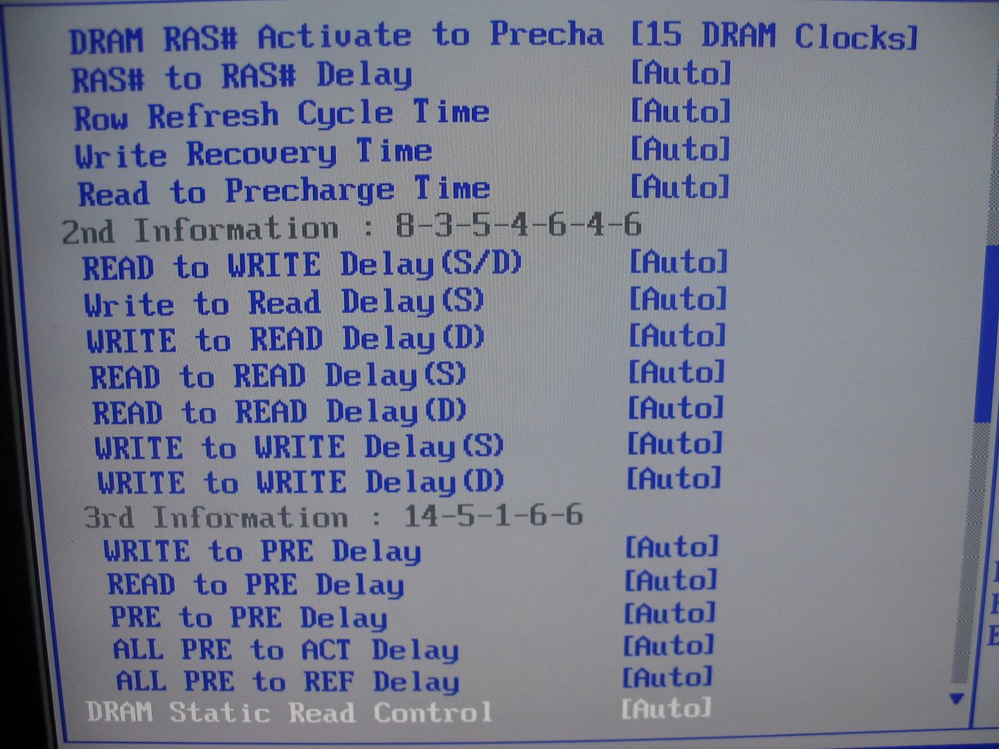

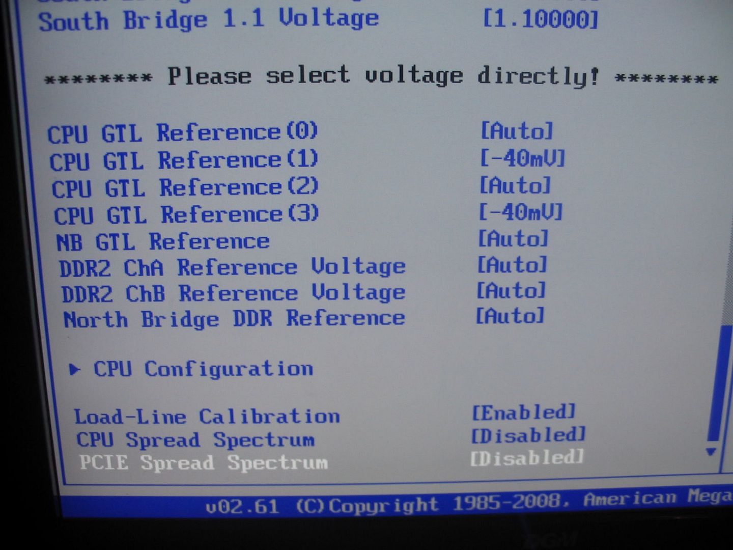

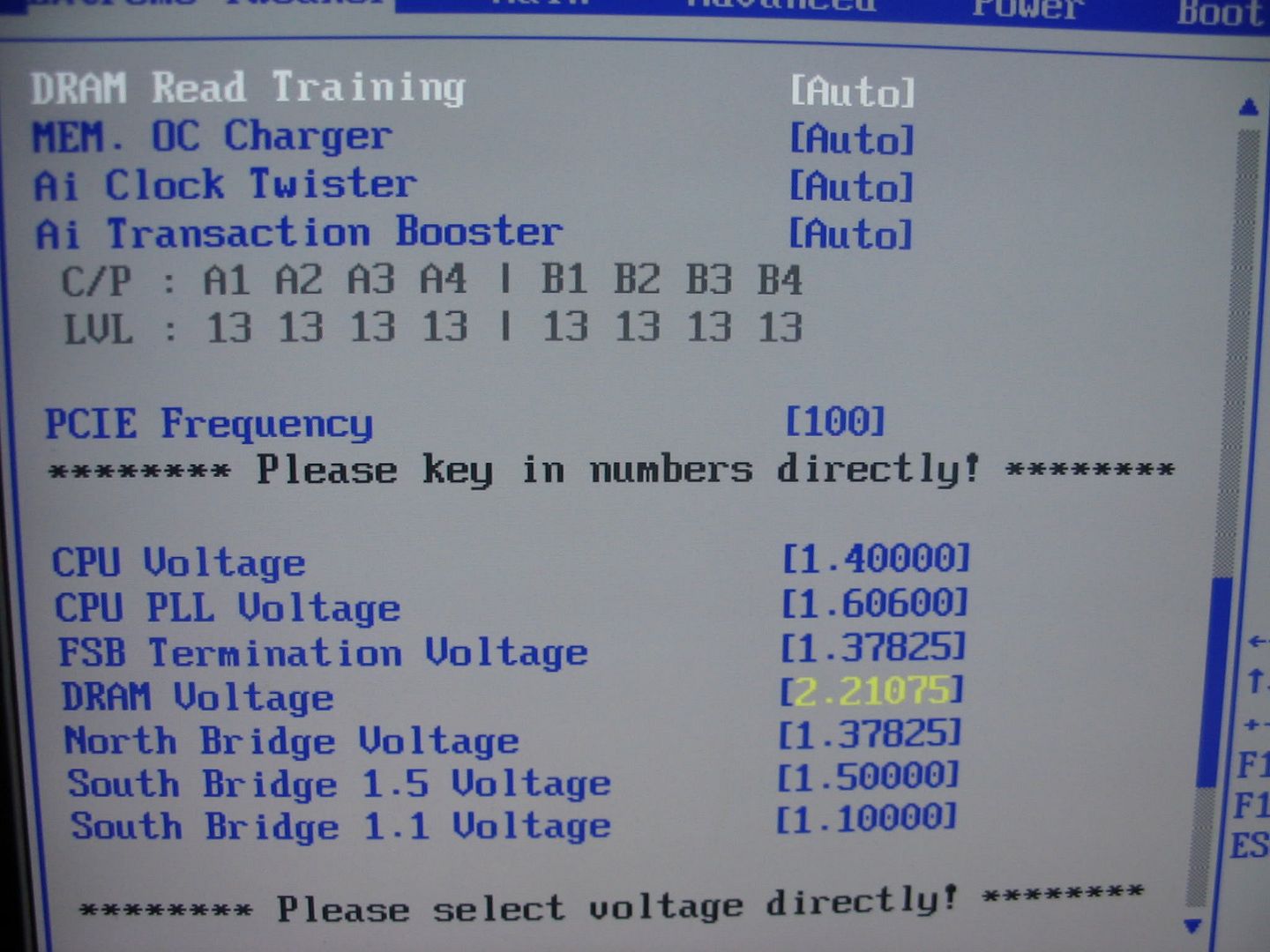

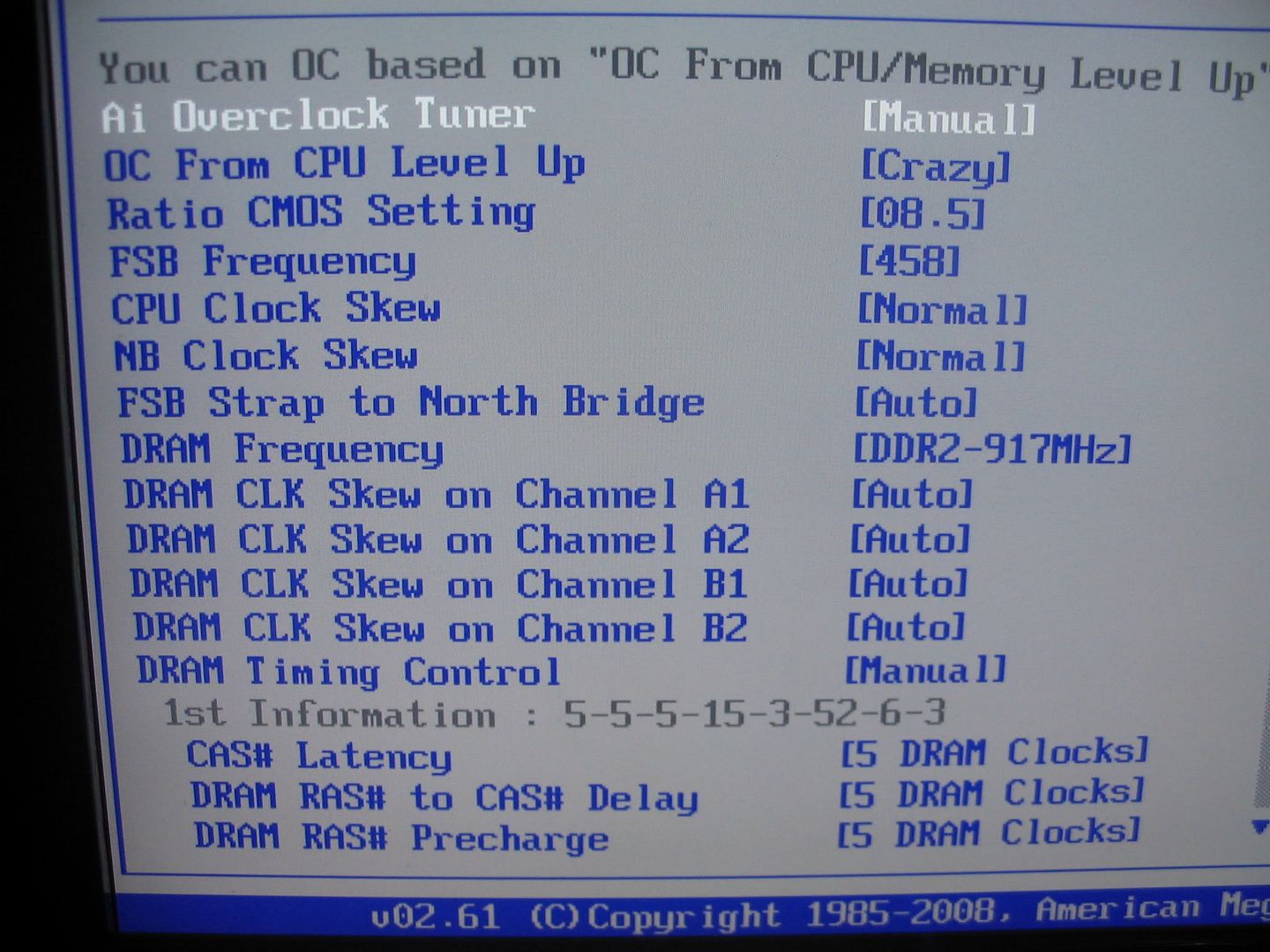

right this is mine, seban i will try yours now, but aaprt form the RAM things, as im not sure this RAM will run at at 1105 or with those intricate timings :D
Code:Processor: Q9550 (E0)
Ai Overclock Tuner: Manual
OC From CPU Level Up: Crazy
Ratio CMOS Setting: 8.5
FSB Frequency: 458
CPU Clock Skew: Normal
NB Clock Skew: Normal
FSB Strap to North Bridge: 333
DRAM Frequency: 917
DRAM CLK Skew on Channel A1: AUTO
DRAM CLK Skew on Channel A2: AUTO
DRAM CLK Skew on Channel B1: AUTO
DRAM CLK Skew on Channel B2: AUTO
DRAM Timing Control: Manual
1st Information: 5-5-5-15-3-52-6-3
CAS# Latency: 5 DRAM Clocks
DRAM RAS# to CAS# Delay: 5 DRAM Clocks
DRAM RAS# Precharge: 5 DRAM Clocks
DRAM RAS# Activate to Precharge: 15 DRAM Clocks
RAS# to RAS# Delay: Auto
Row Refresh Recycle Time: Auto
Write Recovery Time: Auto
Read to Precharge Time: Auto
2nd Information: 8-3-5-4-6-4-6
Read to Write Delay (S/D): Auto
Write to Read Delay (S): Auto
Write to Read Delay (D): Auto
Read to Read Delay (S): Auto
Read to Read Delay (D): Auto
Write to Write Delay (S): Auto
Write to Write Delay (D): Auto
3rd Information: 14-5-1-6-6
Write to PRE Delay: Auto
Read to PRE Delay: Auto
PRE to PRE Delay: Auto
All PRE to ACT Delay: Auto
All PRE to REF Delay: Auto
DRAM Static Read Control: Auto
DRAM Read Training: Auto
MEM. OC Charger: Auto
Ai Clock Twister: Auto
Ai Transaction Booster: Auto
PCIE Frequency: 100
CPU Voltage: 1.40000
CPU PLL Voltage: 1.60600
FSB Termination Voltage: 1.37825
DRAM Voltage: 2.21075
North Bridge Voltage: 1.37825
South Bridge 1.5 Voltage: 1.50000
South Bridge 1.1 Voltage: 1.10000
CPU GTL Reference (0): Auto
CPU GTL Reference (1): -40mV
CPU GTL Reference (2): Auto
CPU GTL Reference (3): -40mV
NB GTL Reference: Auto
DDR2 ChA Reference Voltage: Auto
DDR2 ChB Reference Voltage: Auto
North Bridge DDR Reference: Auto
CPU Configuration:
C1E Support: Enabled
Max CPUID Value Limit: Enabled
Intel Virtualization Tech: Enabled
CPU TM Function: Enabled
Execute Disable Bit: Enabled
Load-Line Calibration: Enabled
CPU Spread Spectrum: Disabled
