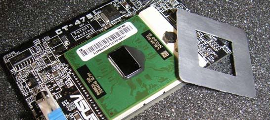

Should be able to use the same mount as you would before the adapter.. and I can cut a plastic adapter for my head if I had the dimentions.
Send me the measurments and where it is blocked.
Thanks Chilly, you rock ("bump" for urban types). One concern I have is the weight of a block and hose on this adapter, basically ripping the sob right off. :eek: I get the adapter and my 760 tomorrow, so we'll see.Quote:
Originally Posted by chilly1
I am sure that the use of a hard rubber shim will be nessassary. or possiably teh adapter will need to include support for the adapter board.

Something you could do is buy a cheap celeron that has a heatspreader and put the heatspreader on the Dothan. You shouldn't get any cracked/chipped cores then (and temps won't be much different).Quote:

Just got 760 and ct-479 today, working on fabbing a shim... :idea:
Here are the dimensions of the Dothan:
http://209.35.180.29/misc/sonoma.gif
Note that the length and width of the die are not exact, as the epoxy on it adds a "slope" down to the silicon. So a shim needs to take that into account...
can we "adapt" an old ship for AXP???
sadly enof i looked at a couple AMD shims and there only .6mm thinck :( can you use a heat spreader off a p4?

simply use 1mm neoprene and you are ok ;)
I'm not sure if it has been mentioned in the other Dothan threads but I tested using a creditcard as a shim and I must say it has the perfect height (assuming the height of the dothan is the same as for the celeron mobiles). Try this! I will most likely use this method this on my upcoming dothan.
(Note: Ofcource, don't use cards that are not 100% flat, some can have leveled digits.)

FYI, the Dothan core is .82 mm above the silicon.
I used a sharp knife to life a corner and slowly pulled using the knife with any tricky bits.
guess i got lucky :)
Originally Posted by stryg
So 1mm neoprene should be just right. The type that is used for wetsuit.Quote:

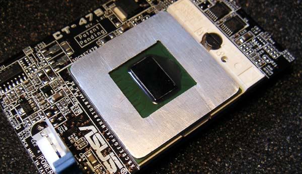

Here is some mounting I did for a water block. This seems like the place to post it. The shim can be made from aluminum bought at Lowes. Lowes sells .8mm stock for a few bucks. I think the die is .82mm.
http://i7.photobucket.com/albums/y26...miniumshim.jpg
http://i7.photobucket.com/albums/y26...inumshimon.jpg
This is just a standard p4 retension mechanism with the holes moved up about 7mm. It's made out of .8mm aluminum and 1/8 in aluminum stock screwed into a retention mechanism.
http://i7.photobucket.com/albums/y26...nmechanism.jpg
Here it is holding down an innovatek cool rev3
http://i7.photobucket.com/albums/y26...mwithblock.jpg

K, here is what I am working on. I've found that the Vapo 478 evap housing fits the stock Intel mounting bracket comfortably with some j-boltage:
http://209.35.180.29/misc/dothan1.jpg
(Notice pins clipped off so evap housing can fit. See also, ghetto shim pads)
http://209.35.180.29/misc/dothan2.jpg
(Proof of concept, as assembled in hardware store)
http://209.35.180.29/misc/dothan3.jpg
(On P4P800-SE - effective if not elegant)
http://209.35.180.29/misc/dothan4.jpg
(On P4P800-SE, underside view)
Still have to do some soldering, obviously, and hook this bad boy up. Prolly get it running tomorrow.

http://209.35.180.29/misc/dothan/tapewire.jpg
Here's the final, ready to go version with no condensation:
http://209.35.180.29/misc/dothan/snake.jpg
More pics:
Insulated
Wired
Plastic (did this to protect socket from another soldering accident). :hitself:
BTW, next to the bolts at the hardware store was this plate, complete with product liability legalese (what, no "do not eat"?):
http://209.35.180.29/misc/dothan/bolt.jpg
So I bought a couple just in case.
Just a proof of concept that I put togther in one minute (Swiftech MCW50 GPU Block):
http://209.35.180.29/misc/dothan/waterplate.jpg
The bolts and plate were too big to use 2 plates and 4 screws along the nvidia mounting plate, but with smaller J bolts and U bolt plates, it might be a more secure solution.
