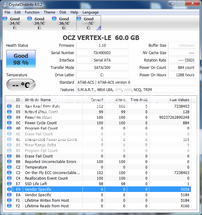

SMART attributes #233 (E9) and #242 (F1)
Attribute #233 records the write to NAND.
Attribute #242 records host writes.
Dividing #233 by #242 will show the compressibility and write applification factors that the controller has achieved against writes incurred by the host.
For SF1 drives these attributes are only updated every 64GB.
For SF2 drives these attributes are updated ever GB
The lower the ratio the higher the compression factor = less writes to NAND and faster write speeds.
Uncompressible 4K random writes induce significantly more writes to NAND than writes incurred by the host system. (Amplification factor of 3.3)
