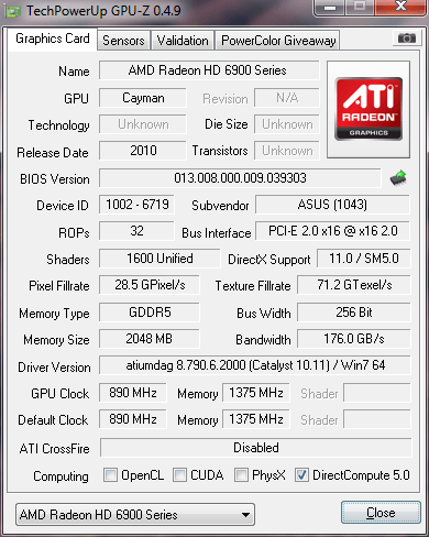

Post here if you tried it. Looks like it worked for me, trying to test now
Instrructions http://forums.guru3d.com/showthread.php?t=335318
http://gpuz.techpowerup.com/10/12/26/avh.png
^That is a 6950!
0.9v idle
1.175 load

I just note that gpu-z shows me 1600 shaders vs yours at 1536.
no idea why though.
Old GPU-z?

Flashed mine and its showing as 1600 SP?
you're using an old version of gpu-z. update it and it'll show it correctly.

2. In GPUz 0.5.0 it says that I have a 6950. Is that correct? My shaders are 1536 :confused:
Hmm...maybe GPUZ is wrong because it report from device ID look at on device ID
list it still 6719 that is a ID for HD6950 but for Shaders i think it real increasing
you can checking with 3D bench
btw. hangs after 30sec maybe your gpu/mem can't running on HD6970 clock speed
try reduce little speed and benching again if it still hangs maybe you a one of
bad luck
Cheers ;)
