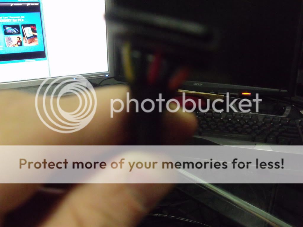

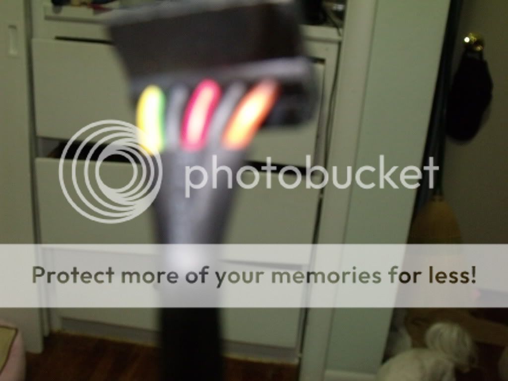

i purchased a ST1500W PSU, and on first boot it fried 3 of my SSD, all 3 were on the same power line. they are vertex gen1 30 gb drives.

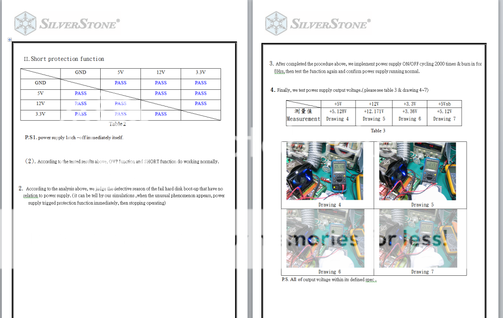

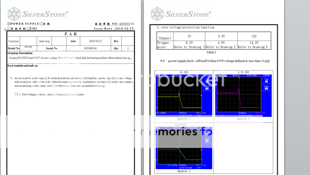

One of the SSD actually began smoking very badly, and was apparently the cause of the issue. I contacted silverstone and they did some testing of the unit, as a matter of fact VERY detailed testing. i will post their results, they tested teh PSU, and the wire the devices were on, even taking photographs of the entire testing process.
They are assserting that a error with the drive caused an overvoltage on the wire that all the devices were on, thus shorting the other two devices.

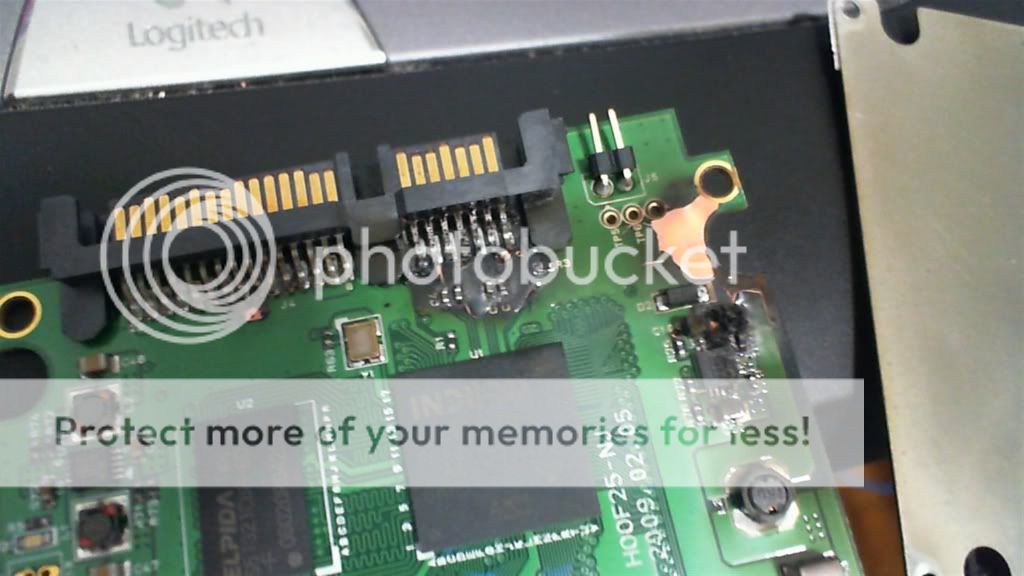

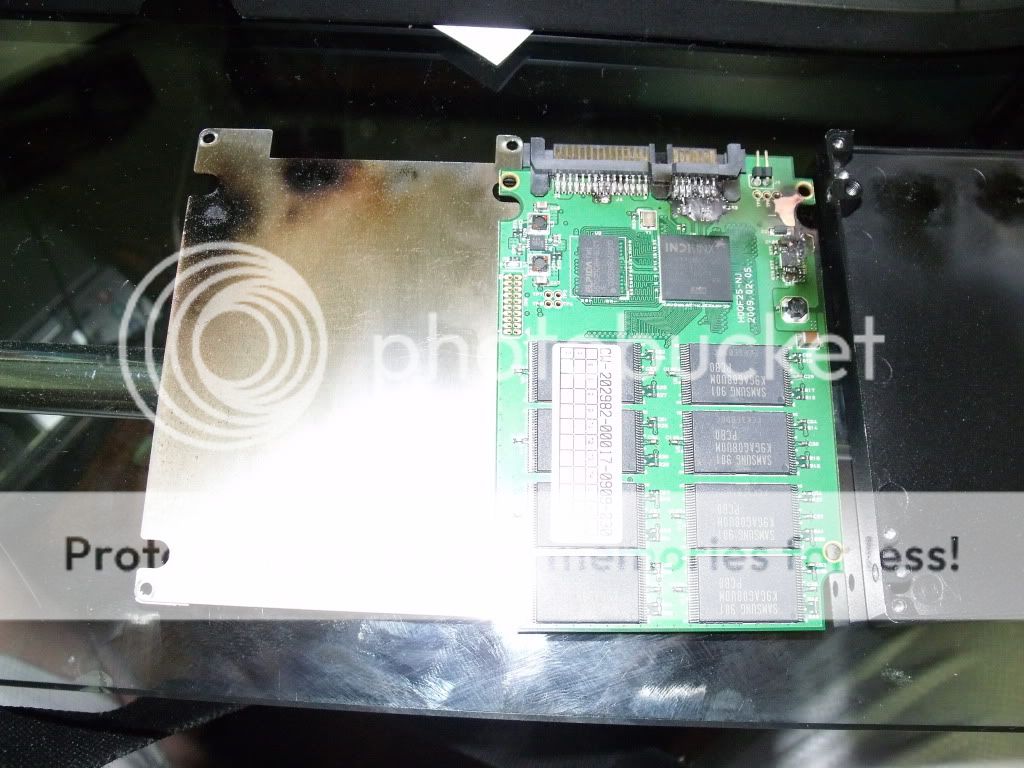

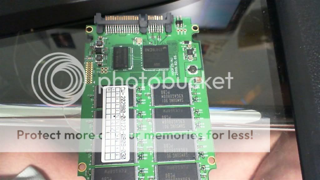

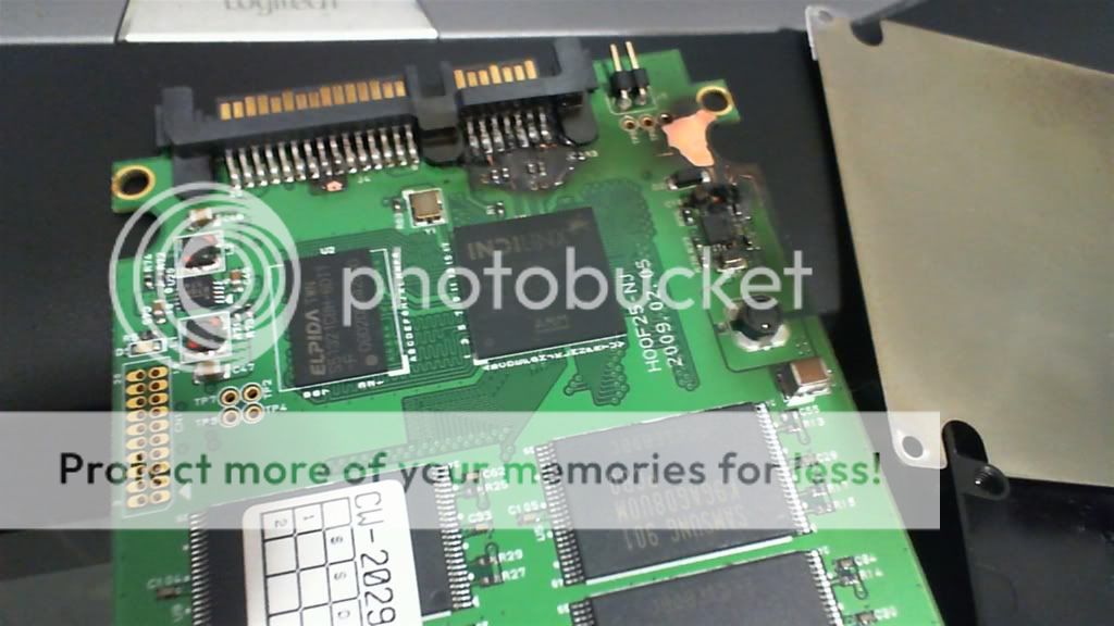

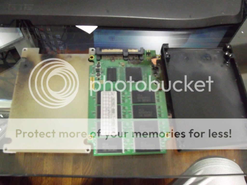

Upon power on to the SSD from another PSU, same result. the SSD starts smoking badly. so i dismantled the drives. the two that were not smoking show some very slight sscorching on a particular part, but nothing near what the one that fired up shows.
funny thing is that the damage is not near the power socket of the drive. it is near the SATA port and the side of the pcb.
