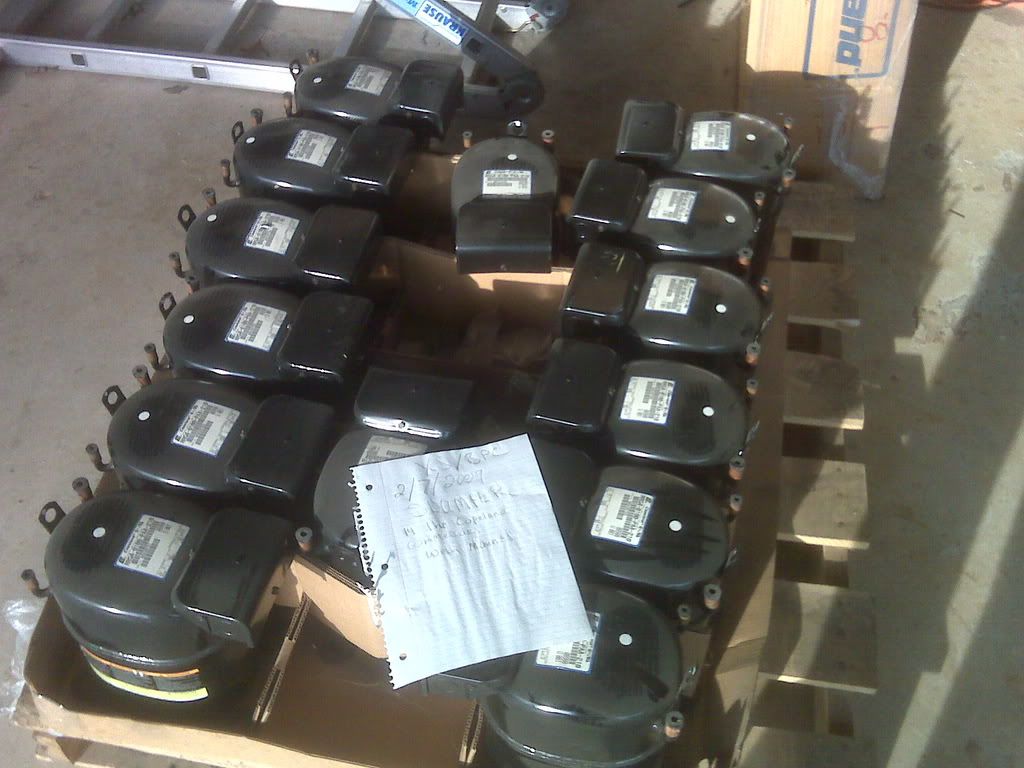

My 1HP Copeland Compressors arrived are they too big for a SS?
http://i190.photobucket.com/albums/z...r/IMG00249.jpg
Lol I hope that isn't a serious question :p: Those things are monsters :up:
LOL they really are very big compressors :)
Ideal for autocascade with r23 in final stage, nehalem killerrrrrrrrrrrrr:D
give it a shot dude! :)
too big, no way:D, u ever see drewmeister ss 1hp:D, would make sweet cascades, maybe r1150/r14:yepp:
Oooh nice looks like the compressor in my autocascade. It's a Copeland RF41C5E-CAA-250 I believe.
Tell me about it, I would love to use R1150 in mine. Actually, I would love to add something like R14 to the mix and add another HX if I am going to dream! I just can't get anything good around here. :(
14x 1HP compressors :slobber:
