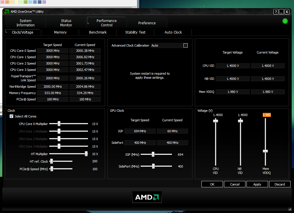

As far as AOD goes, it seems to work OK but has limited adjustments compared to the Asus 79-T and most other boards I've had. The sliders for CPUVid and NBVid act a little strange, if you don't set them to the same Vid they will jump to the lower of the 2. Actually, that is very similar to setting them in BIOS, IE: there is no adjustment for NBVid and setting CPUVid applies the same setting to the NB. If you want to give more juice to just the CPU you need to use the CPU offset voltage. Heres a SS of my best current OC:
http://i30.photobucket.com/albums/c3...BiostarAOD.png
This 9850 (0811 BPJW) is pretty weak, so that really isn't too bad considering the short time I've had to play with it.... ;)
