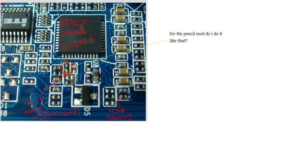

I made a quick mock-up of Hicookie's written guide.
Pins 16 & 17 are marked with red dots but since the pic isn't detailed enough I can't pin point the best soldering points. The legs of ISL6336 might not be too easy to solder on, you'll have to follow the trace that leaves from each pin and find a usable soldering point. Or, you can post a detailed macro pic of the area so I can find & mark actual soldering points.

i take my board back , and done the vmod, you can try pencil or just change the vr.
http://pic.xfastest.com/hicookie/Gig...roopingmod.jpg
On which do I do the pencil mod? the one that says Vcore reading?
Please tell me for pencil mod if the yellow line in picture is the one that I apply the Pencil mod to?
http://i257.photobucket.com/albums/h...Untitled-3.jpg
Also if I want to do the solder mod what size resistor should I use?
The circled part would be the resistor to pencil.
But it seems the effectiveness of the pencil mod will be non-existant due to the resistance of the part (it's lower than Hicookie reported earlier). One simply can't get from 3.6kΩ down to 146Ω by pencilling. Soldered mod seems like the only way.
