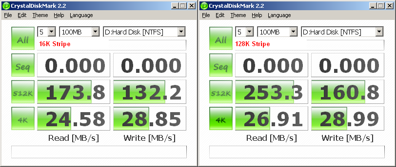

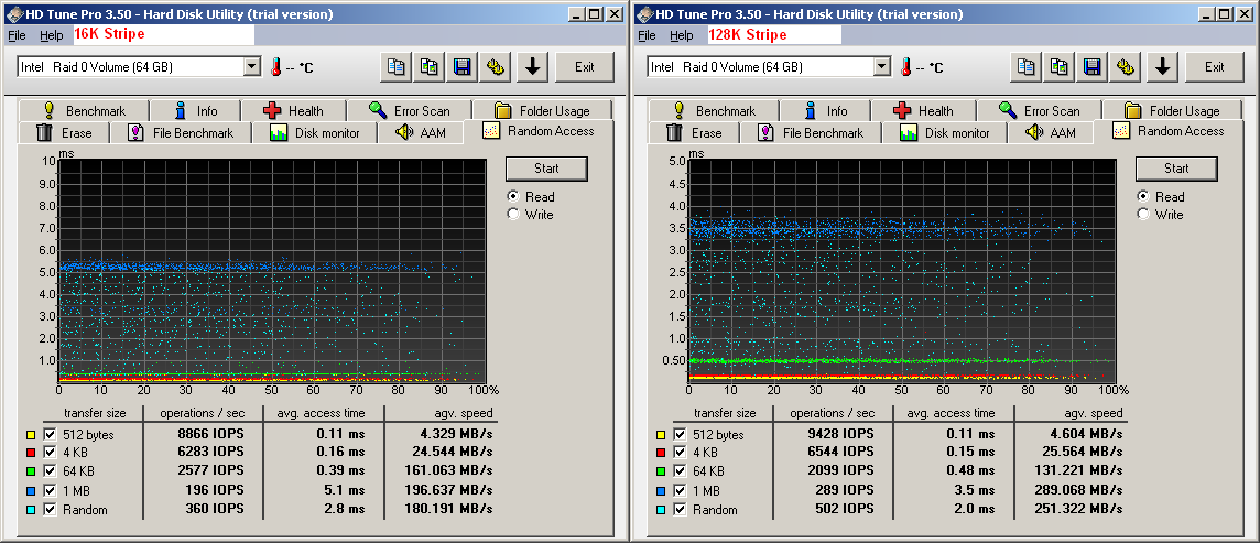

Here's quick 2x30Gb 1.3FW OCZ Vertex RAID-0 on ICH10R 1.20 tests: 16K vs 128K stripe size.
http://i214.photobucket.com/albums/c...-128K_HDTR.png
http://i214.photobucket.com/albums/c...6-128K_CDM.png
hey F@32 would you mind running it at higher stripe ifn you can?
sorry lol i need to pay attention :)
