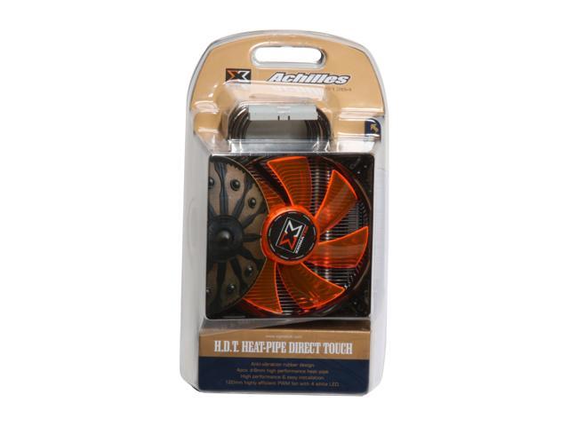

didnt know if anyone knew, didnt do a search but ill post it anways
http://www.newegg.com/Product/Produc...82E16835233017
http://c1.neweggimages.com/NeweggIma...233-017-02.jpg

Nobody seemed to listed to me when I said that Benchmark Reviews had tested the final version. I tried to tell you guys.
Xigmatek is gona have some explaining to do.
hum interesting. Kinda Pricey. the old S1283 will still be the better buy.
I was listening :D You had to know if they're shipping retail packages to reviewers that they aren't unfinished samples. They had to have a whole storeroom full of them.
:shrug: To who?? End users? I ordered one yesterday.
oh well, hope people won't buy it to upgrade their S1283, cuz I doubt there will be any.
I'm so glad someone was picking up what I was laying down! :cool:

What I meant was that Xigmatek had sent me the final version... or at least as far as they knew at that point in time. It wasn't until I revealed their design flaw that they went and ordered a redesign. Know I realize that philosopically, nothing is ever final, but I believe they meant the version they sent Benchmark Reviews to be 'it'.
Now we know it was, but my Xigmatek sources tell me the design is being 'adjusted' and that the new revisions will be available in product around the first part of June.

To be clear, they have only said that there will be a replacement version introduced in June. I am not making any promises, because some of the information they have released to me has been contradictory. If they do as they say, the new version will address the contact area of the pipes so that the entire processor is covered.
