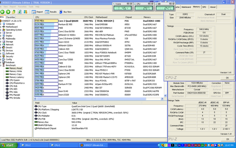

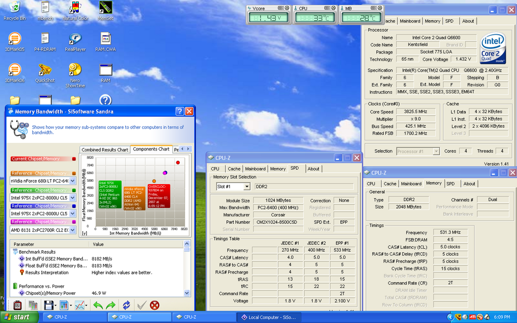

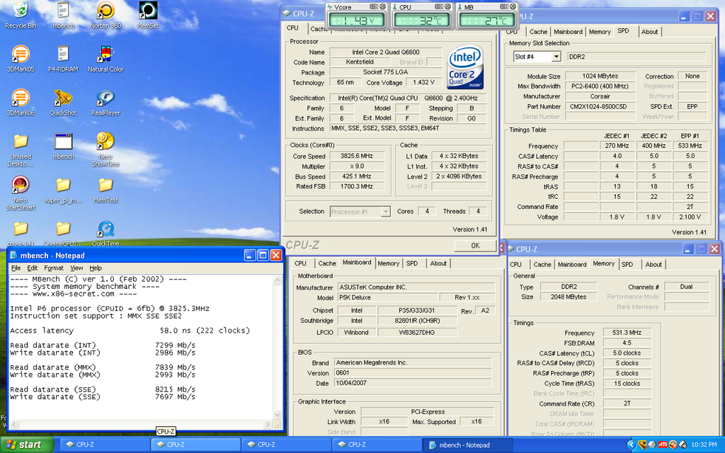

I've been testing these modules for a little over a week on the P5K deluxe and although the results are not as impressive as bachus_anonym I am impressed.
They do what they are rated at and up to about 1088 stable @ stock voltages and latency.
anything above that so far hasn't been achievable and seem unresponsive to voltage increases.
the difference on my part is likely due to the fact that I do not have a fresh clean install and Q6600 G0 instead of the E6850.
http://i201.photobucket.com/albums/a...7_18-09-22.png
http://i201.photobucket.com/albums/a...7_22-32-43.png
http://i201.photobucket.com/albums/a...7_22-47-19.png

I just bought the 2GB (2 x 1gb) of these modules, ver 2.2 and they are giving be BSODs on my P5B Deluxe. Any specific settings i need to make? They are running at ddr2 650mhz but if i change the strap on the board to 800+Mhz, it doesnt boot.
If you are at 650mhz, then you are WAY past the tested settings and are on your own as far as OCing. Make the modules are well cooled. Also, that speed on a 965 MOBO, you are most likely going to have to run the 1066 strap (does it even have a faster strap???) as the chipset latencies will be too tight at the 800 strap.
What voltage are you using?
650mhz as in 2 x 225Mhz. My FSB is 225mhz! That isnt way past the tested settings as the ram is tested to run at 1066Mhz! Im almost half that! It's running underclocked. I tried 1066 strap at 2.1v but it wont boot. Now its at 1.9v and 225mhz with 5-5-5-15. Latencies wont tighten either.
Actually, they are tested to run at 533mhz, not 1066. What memory divider are you running now?
Also, you need to tune your memory controller voltages and raise them a bit to run that speed.
Keep in mind you will need run the 1:2 memory divider to get anywhere close to 1066 on the memory if your FSB is low. What CPU you are you using?
Im using a quad core Q6600. Its running at FSB 266 x 9. My voltages are as follows:
CPU-1.28
Ram: 1.9v
NB: 1.55v
SB: 1.5v
