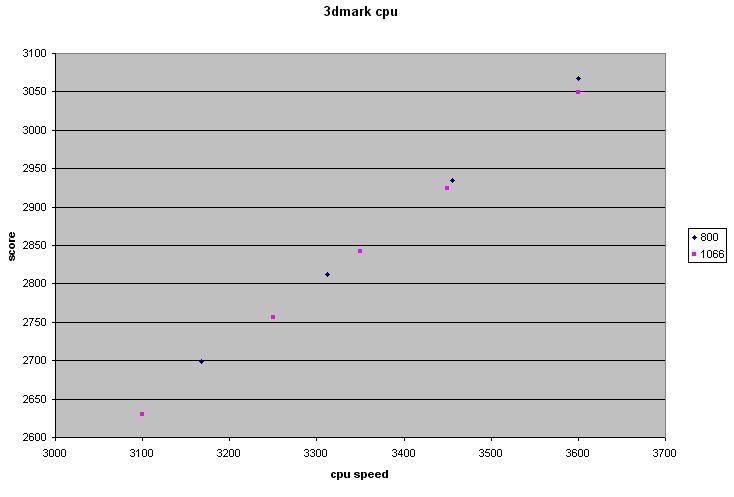

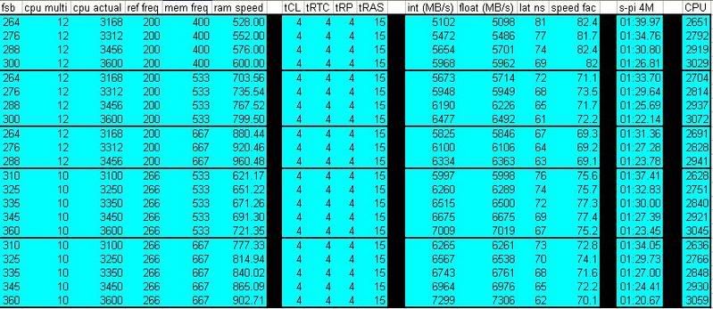

975x (BX2) strap evaluation
I'm selfish and wanted to start a fresh one for my work here. Please comment and i can send you my work if i can't get my thoughts across here. I probably made this too hard on myself and probably also need to try different multipliers, but here it goes.
Some background on the BX2:
As with a few other higher end 975x boards, the BX2 allows you to set the chipset strap independent of the FSB speed. In bios this option is referred to as the reference frequency. This reference frequency also sets the possible memory dividers. I am testing this because it was thought to be that running higher multipliers on tighter straps results in better performance at lower FSB speeds.
First off i ran a string of FSB for both the 800 strap and 1066 using 12x and 10x multipliers respectively that covered from ~3100 --> 3600 MHz on the cpu. In order to keep as much as possible the same, i held all memory timings constant and ran at all of the stable <1 memory dividers.
my chart
http://i18.photobucket.com/albums/b1...hung/chart.jpg
after setting all this up, i needed a way of comparing the cpu speeds on each strap at equal memory speeds. Although with the divider settings on 975x boards you can't get equal memory speeds across a range of different FSB speeds, i figgured out a way of at least getting a theoretical value. From each reference frequency/memory frequency combination, i calculated the CPU/Mem speed ratio and used that to set an average ratio between the 2 that I could use as my reference point. I had to extrapolate theoretical performance values at each CPU speed based on this unachievable memory frequency. When i did this I was able to compare how each strap would perform if it was able to scale memory frequency as a function of CPU frequency rather then FSB speeds.
i had to make the assumption that the latency changes that the board imposes when changing the divider still result in a linear relation between FSB and memory speed.
Here are my results.

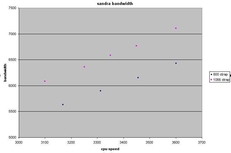

http://i18.photobucket.com/albums/b1...uhung/band.jpg
As you can see from the table here. The increase in FSB speed opens up much more memory bandwidth. This is completely to be expected.

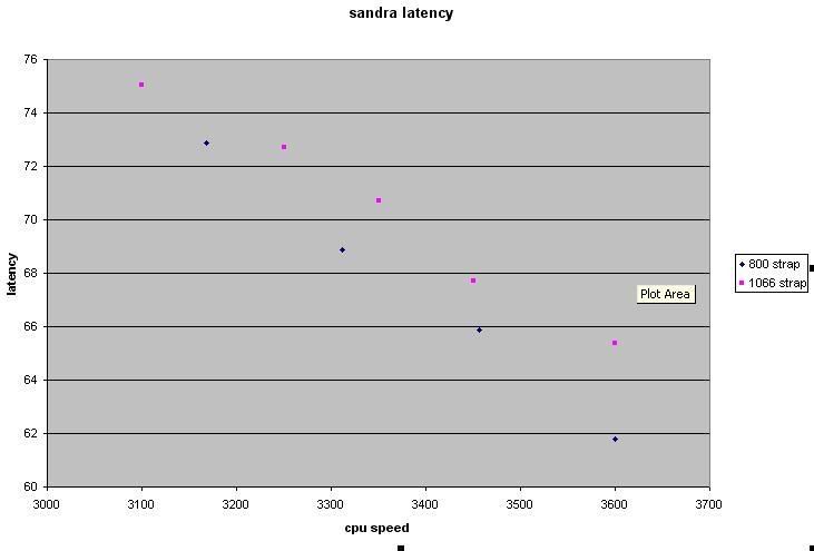

http://i18.photobucket.com/albums/b104/blauhung/lat.jpg
The tighter chipset latencies on the 800 strap take the cake here.
so bandwidth and latency are squaring off, who will win?

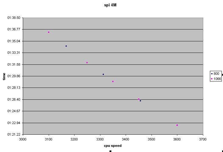

http://i18.photobucket.com/albums/b104/blauhung/spi.jpg
http://i18.photobucket.com/albums/b1...ung/3dmark.jpg
from super Pi times and 3dmark06's CPU test, it seems to say that at these CPU multipliers both straps are performing exactly the same. I will have to test more multipliers so that I can get a better feel for this, and i should extend it to the 1333 strap that most are operating at above 400 FSB for Intel chipsets. But this gives you a good idea of what is going on at least between the 2 faster straps.
be aware that at a given FSB speed, the tighter strap will always be faster. thus its possible i just happened to fall on the break even point of where the 2 end up with equal performance and I will see the 800 strap doing better then same cpu speeds on a 11x multi and worse then same cpu speeds on a 9x multi
