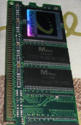

just got these from my distributor in my country :
Twinmos "value" PC3200
Chipset : M.tec
week : 05094
Pic :
http://img.photobucket.com/albums/v5...5094_512mb.jpg
i'll be back with the result
