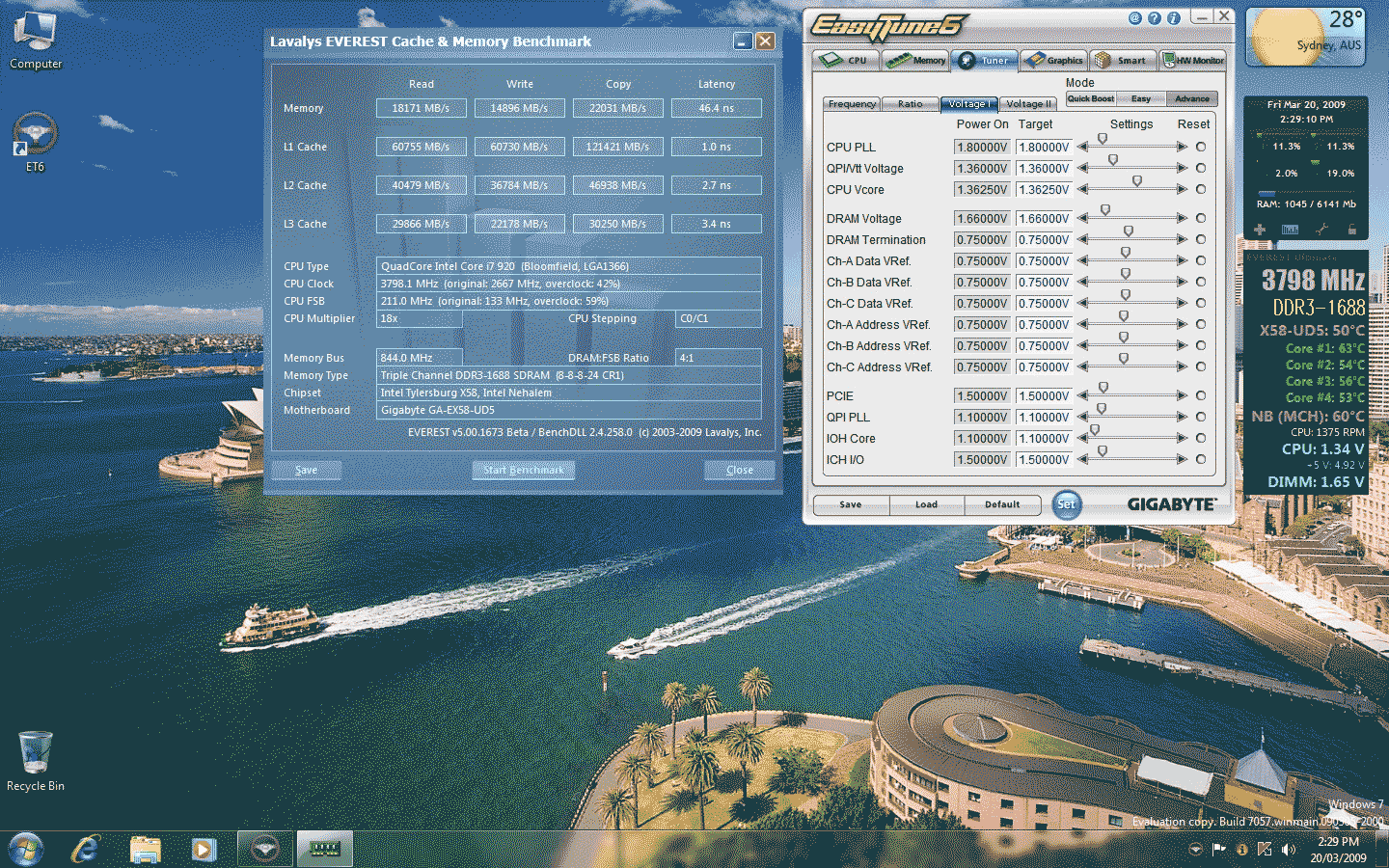

Well ReverendMaynard I took your advice and tried to find a good setting with a lower QPI/VTT.
Dropped QPI/VTT from 1.4 to 1.36, All MCH settings back to auto and NB temp drops 5 degrees. CPU from 4Ghz to 3.8, memory performance still at 1688Mhz. CPU load temp after 30 minutes ~70-72 degrees.
Here it is in glorious windows 7 16 colours ;)
http://i105.photobucket.com/albums/m...i7-X58-UD5.gif
