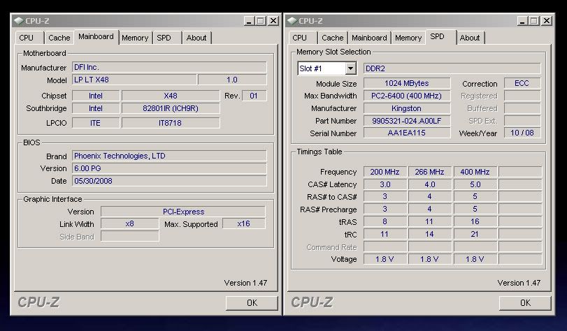

Does anyone know if this mobo is compatible with ECC RAM? I know the X48 supports ECC, but I'm not able to find any documentation that confirms its supported by the X48-T2R.

from what i read on a dutch webshot its not ofcourse i dont know how accurate there info is.
http://www.highflow.nl/index.php?tar...product_id=419
ECC-geheugen wordt ondersteund Nee

No problem here.
http://i94.photobucket.com/albums/l1...48_t2r_ecc.jpg
