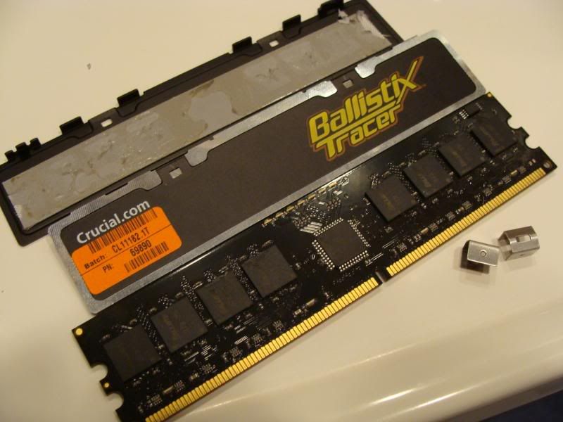

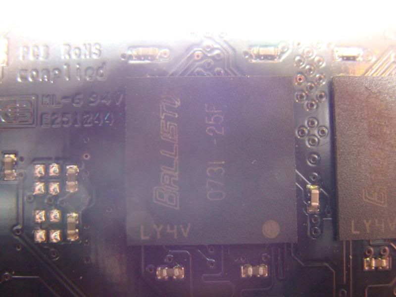

also kinda off topic i took the heatspreaders off of my ballistix tracers, but dont know what chips they are.
http://img.photobucket.com/albums/v7...mputer2001.jpg
http://img.photobucket.com/albums/v7...mputer2010.jpg
chips say 0731-25f
you gonna void warranty lol just test them
good thing you didnt rip the chips off the pcb on the ballistix:rofl:
if you can do 1100mhz 4-4-4-12 with 2.3v i think they are d9gkx
