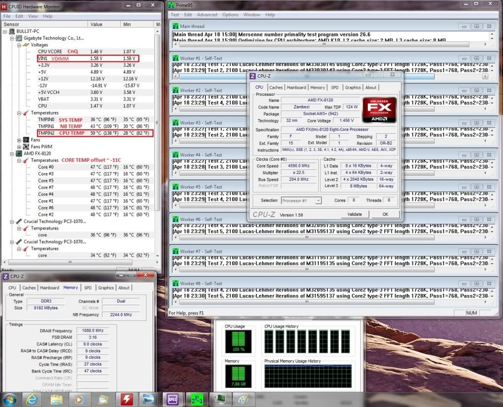

Latest config:
http://i1149.photobucket.com/albums/...XCrucial-2.jpg
1087MHz (DDR3-2174) 9-9-9-24-33 2T 110ns 1.65V
http://i.imgur.com/I9YY5l.png
1104MHz (DDR3-2208) 9-9-9-24-32 2T 110ns 1.67V
http://i.imgur.com/LA8nXl.png
Click for full res.
*Note: Not sure what's the real vdimm, I have soldered a wire for vCore only. Might be more, might be less.
Impressive results! Grats mate!
Strange that loosening tRC didn't helped me, but just vDIMM. And like all Micron they scale pretty well with voltage, probably could do 2240 - 2250 with 1.7V if the scaling is still linear.
I got a bit over 2300Mhz a few pages back with 1.7v.
