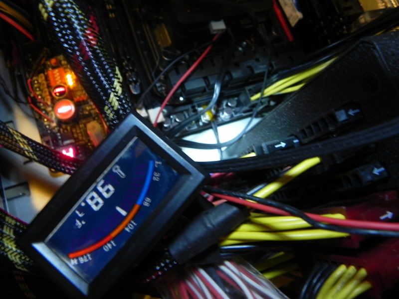

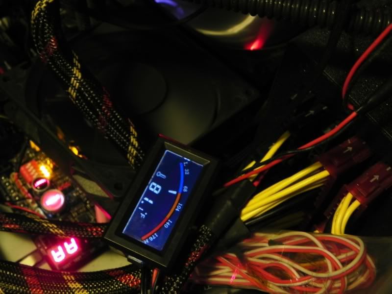

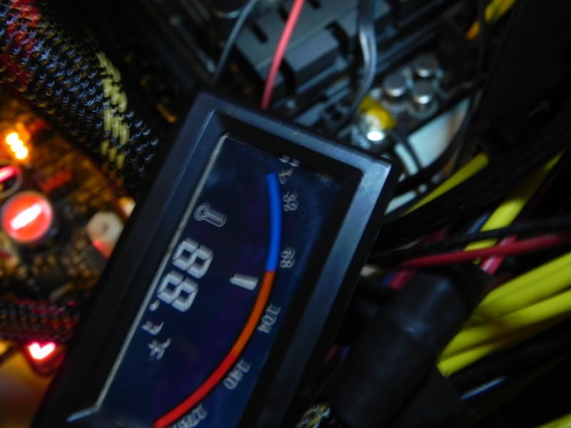

Am I seeing this correctly when i see that they are testing these temps without fans on the VRM heatsinks and they are getting 83c and higher off the top of a heatsink?
So I was wondering what it would be with the probe under the heatsink with and without fans so I tested it.
Here are my results with R4E Idle All Stock settings with and without Fans
http://i89.photobucket.com/albums/k2...EMPSR4E018.jpg
http://i89.photobucket.com/albums/k2...EMPSR4E021.jpg
Im wondering what it cranks up to while under load!
So I set a 4.375 Normal OC profile preset from Asus R4E and loaded it with Vantage
With No fans
http://i89.photobucket.com/albums/k2...HeatVRM012.jpg
After the vantage run I put a few fans on the VRM and it took a pretty long time to drop temps to 87 (over 5 minutes)
I cant wait to get another UD7. I just like the Gigabyte board better
I think at xfastest they tested under the heatsink, but at stock frequency and 1.4v set with highest level LLC, those were their only restrictions.
^ your reading is in F not C from the looks of you screen, under load it is about the same as the normal temp of the human body lol. If this is the case it is running very cool, it can safely run at those temps for 100 years.
Thats hilarious! Thats exactly what I was thinking when I was taking the picture! I think their readings were in F as well. If not then thats fairly hot. 85c is 185f. That would be pretty hot at idle. I am actually shocked it didnt go up higher under load.
But that was with no Digi settings changed at all.
I had this set at 1.4 and I think the profile auto sets LLC to medium. Dont know why its running as cool as it is. Ill leave the heat sensor on and run it to 5.0Ghz at 1.5v and run vantage again. It seems odd that my temps are so much cooler then theirs. I wonder if they were under load. I cant read the language to tell!
Edit, I see their readings were in C. Wow, Wonder why so hot?
