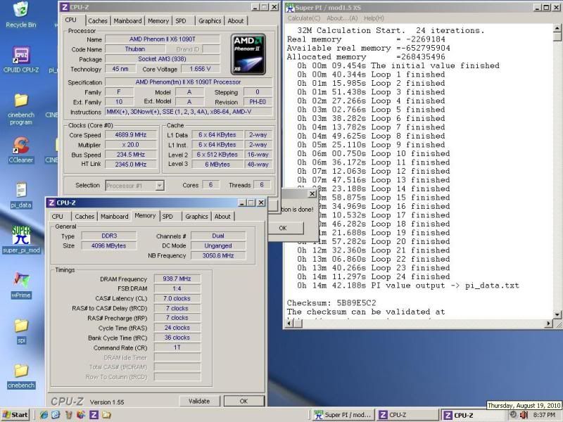

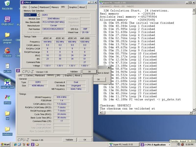

equinox1 , 938 mhz , 7-7-7-24 1t , 1.685v , 4689mhz cpu , 2x2gb corair dominator gt's , asus m4a89td pro , 890fx
http://i31.photobucket.com/albums/c3.../938memcl7.jpg
http://i31.photobucket.com/albums/c3...938memcl72.jpg
winxp 64 bit chilled water
and for the interesting part of the chart
