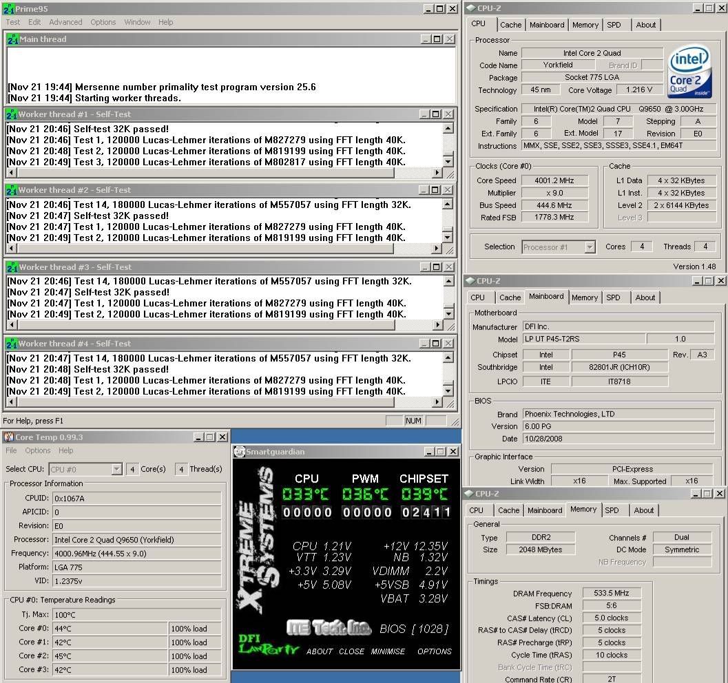

Q9650 in da house :D
Only had it 2 hours & I can tell already we are going to get along just fine together.
http://i106.photobucket.com/albums/m...650/4GHZ1H.jpg

Yeah you will enjoy the Q9650, by far the best processor I've seen.
My Q9650 needed 1.15vcore for 4005Mhz and 1.10v for 3600Mhz.

Thanks bud, I know everyones got one & I know 4GHZ is a breeze but the last quad I had was a Q6600 that did about 3.8GHz so the Q9650 is blowing me away.
I am gonna rap it in for the night its 1/2 one in the morning here (time flies ay) I have her running at 4.3GHz 1.328v loaded right now & she's stable but I'm starting to bully the board a bit with voltage so I'll quit now & start by tweaking the GTL's out tomorrow.
Sure I'll shoot for 500 x 9 but I'll probably aim for about 4.2GHz for daily use. I'll most likely stay on the 333/800 strap/divider & run 4 x 1gb sticks. The P45 boards PL is one behind the P35,X38,X48 etc.

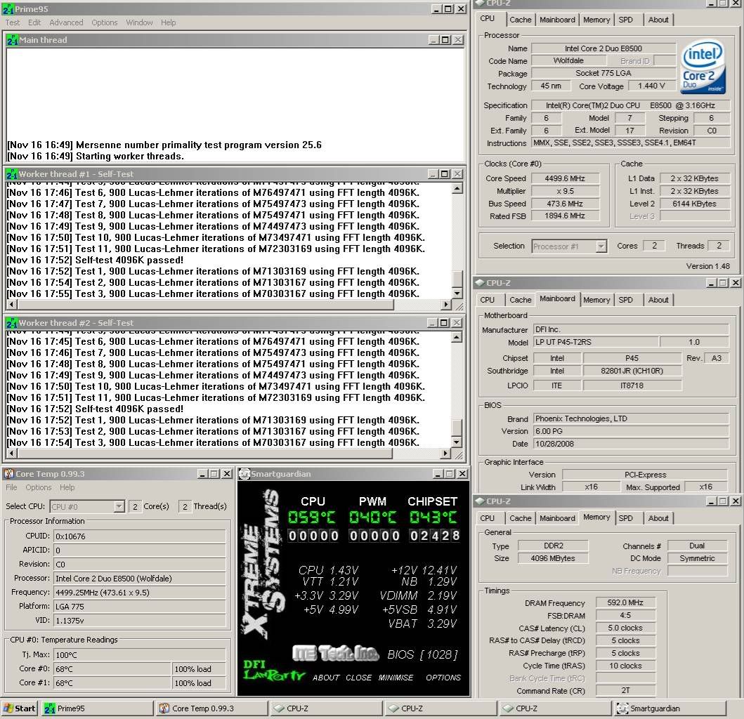

Hi,
I can open windows but I can not stable at 470 fsb with 4 ghz at Q9550 C1 revision.I want to use 24/7 at 4ghz.Can anybody help me?
