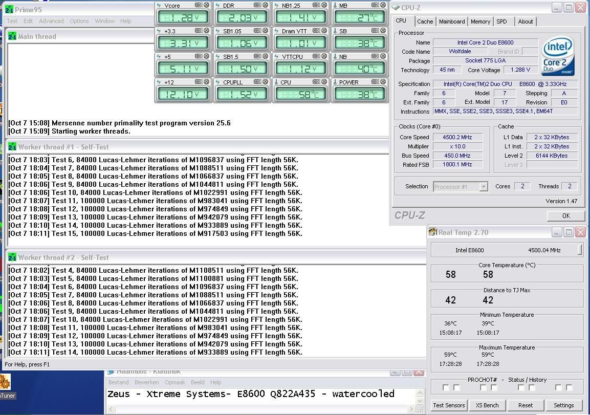

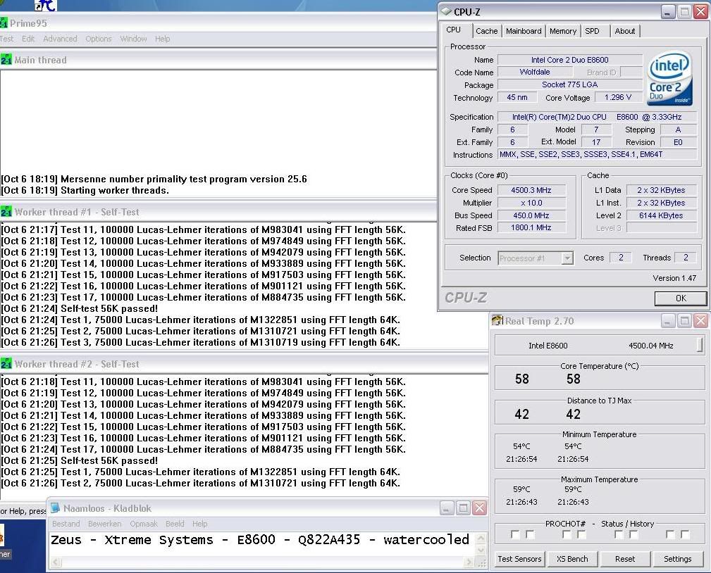

Just like Infa says, the tempsensors are stuck its a known problem on these 45nm chips, I got the exact same stepping as you and have the same problem. Movement of Core 1 is 0 and Core 2 is 3. My block is fitted right and makes even contact. I had these problems before with another E8400.
I mean even at 10x333 with 1.1v i get 41 degrees idle. And then when I Prime is stays at 41 degrees. So bad temp sensors, but great stepping.
Wouldn't wanna RMA it in a liftime :P
