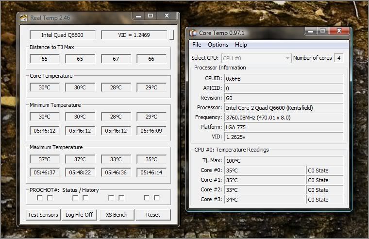

Core temp shows a VID of 1.1250 vs Real Temp saying 1.2375. Default on first boot was 1.2v bios, with 1.18 idle CPUz. Real Temp is closer to the bios with this Q9450.
As I said before, the documentation from Intel is lacking and VID is stored in multiple locations and you also have your current VID as well as the max VID. RealTemp is presently reading what it thinks is the current VID. I'm not sure what MSR that CoreTemp is reading or what formula it uses to determiine voltage. The more feedback and numbers the better. I'll be updating the main link within a couple of days. RMClock also displays VID so you might want to compare to that as well.
Edit: I think I guessed right when I was playing the game of trying to interpret Intel's missing documentation. As for the competition, well I'll let you come to your own conclusions. The VID displayed in RealTemp also changes as my wife's laptop goes through its SpeedStep / C1E transitions so I think I'll be keeping this new code just as it is, even if it doesn't always match CoreTemp. :D

now Realtemp says VID = 1,225 and that is the same as on the E8400 Package label 1,225 maxV. Coretemp reports 1,1125V.
:D RT says VID 1.1250, CT 1.0000 and BIOS stock auto setting is 1.0800.

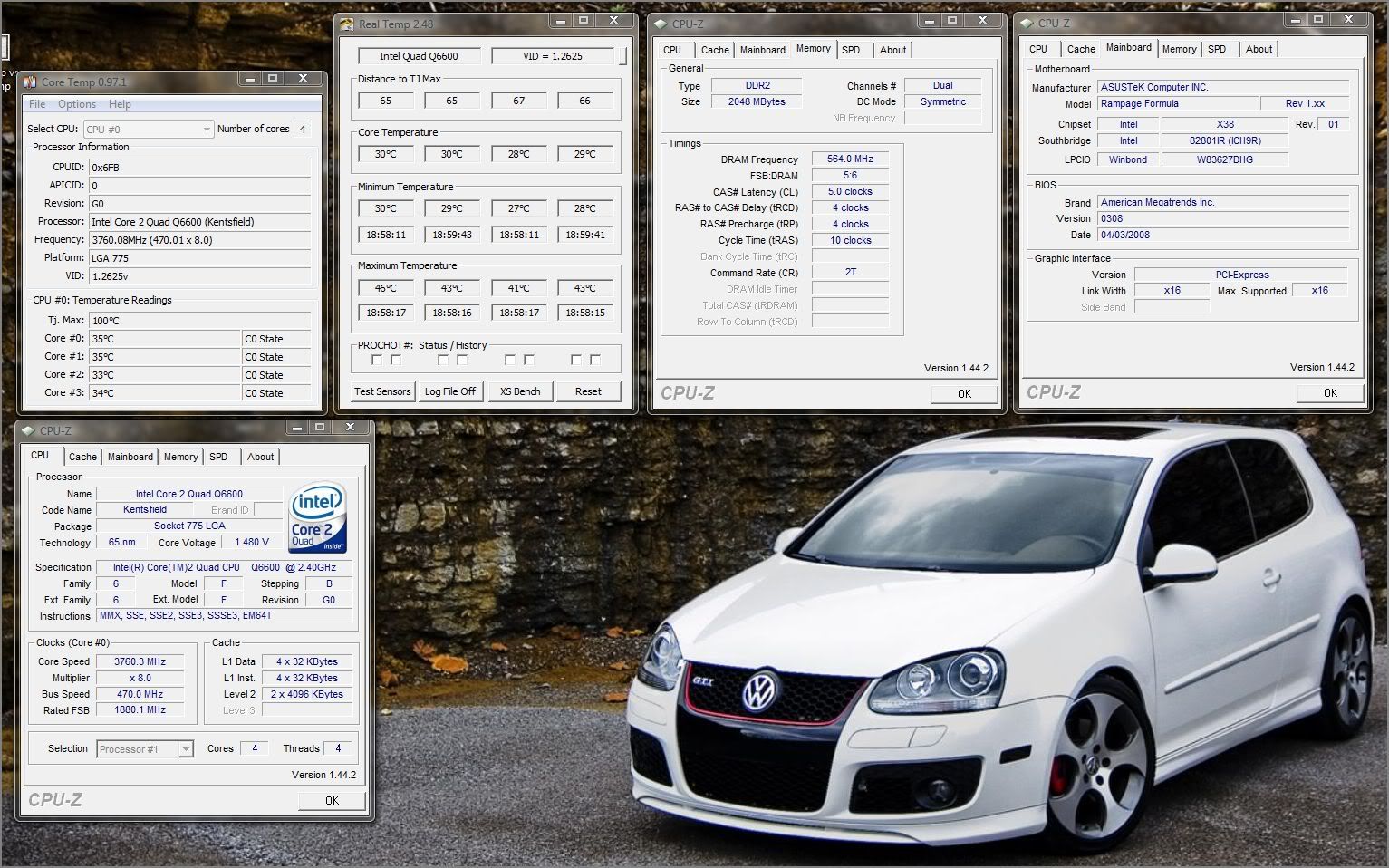

Coretemp VID for my Q6600 is the same on my 680i as it is on my P5K-E.
Only have P5k-E screenshot atm.
http://img2.freeimagehosting.net/uploads/e39a54251a.jpg
I just found a trick in CPU-Z. If you go into the cpuz.ini file and set this value to OFF:
Sensor=OFF
It tells CPU-Z to not read your sensors. Instead of displaying your measured Core Voltage, it will display the VID instead. So far, RealTemp is matching what CPU-Z displays for VID. If yours is different then post a screen shot.
http://img241.imageshack.us/img241/1456/cpuzvidih0.png

2.46 shows lower VID than Coretemp
http://i41.photobucket.com/albums/e2...vscoretemp.jpg
Interesting, the new version 2.48 realtemp has an identical VID as Coretemp.

Is this what you were after uncle?
http://img87.imageshack.us/img87/8374/35750430mo2.png
http://img294.imageshack.us/img294/6766/97880730zs9.png
Ambient temps were 26 degrees.
