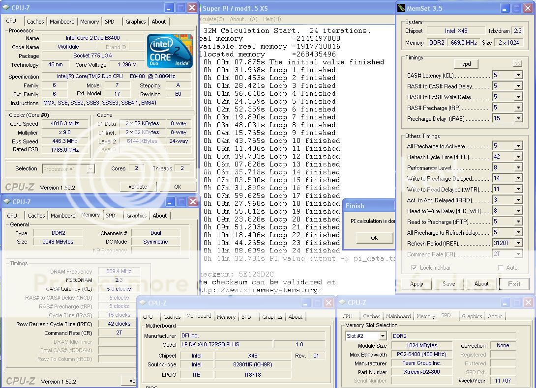

I found myself in a rare mood of hardware nostalgia, so I thought I'd bust out my old DK X48-T2RSB Plus and some Team Group PC6400 C3's.
I posted this in a separate thread but I thought I put it in here too. Here's the results.
Timings: 5-5-5-15 | tRFC 42 | tRRD 3
Test run - 670 MHz | PL8 | 2.45 vdimm
http://i720.photobucket.com/albums/w...I32M669MHz.jpg

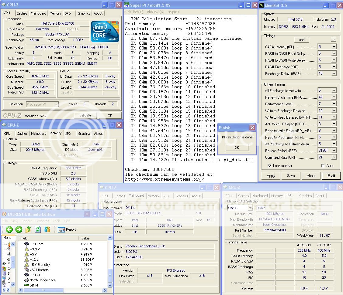

I wanted to get >680 MHz SPI32M stable since not many people have managed to do so. I was hopeful this kit could do it, and it didn't disappoint. The board did well too. I'm going to stop here, raising the voltage anymore would be reckless and things weren't scaling well anymore so gains would have been minimal.
SPI32M @ 683 MHz (DDR2-1366 MHz) | 5-5-5-15 | tRFC 42 | 2.656 vdimm
http://i720.photobucket.com/albums/w...I32M683MHz.jpg
