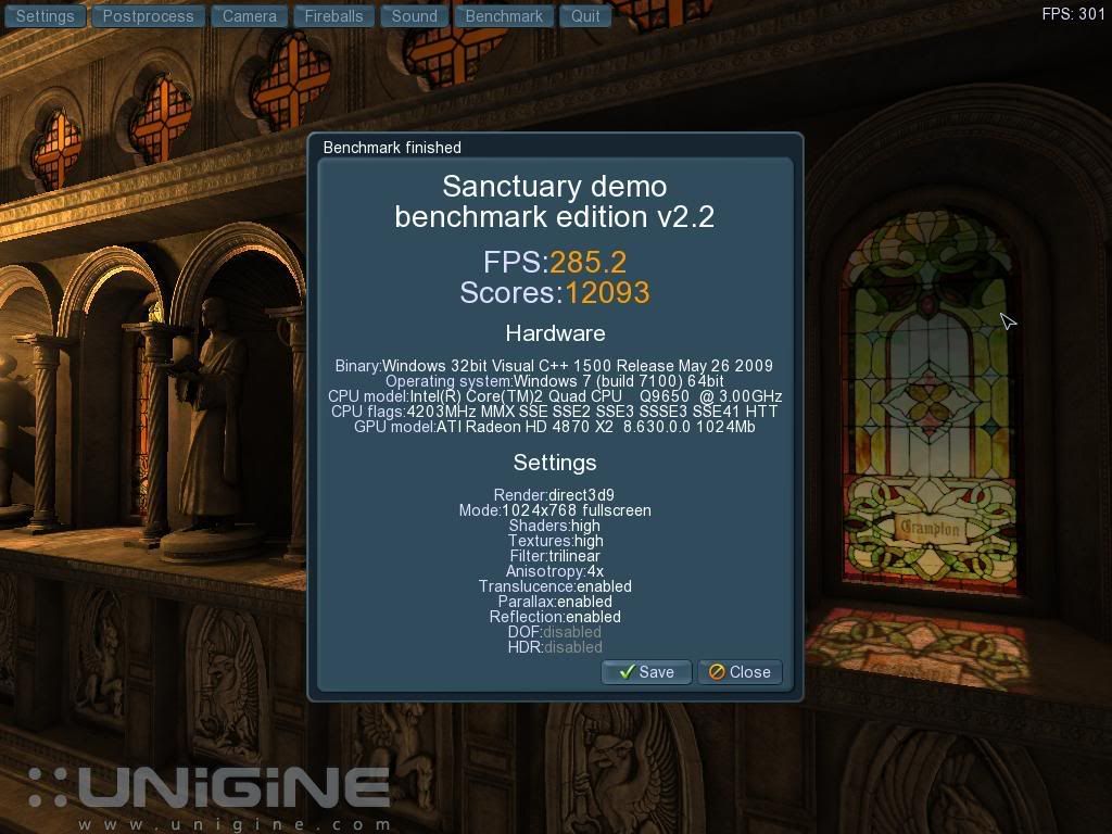

Ran Sanctuary 1920x1080 8Xaa 16Xaf. Had to back my core clocks down to not artifact. Hard test to run at hi res/hi settings.
http://img261.imageshack.us/img261/2...f1920x1080.png
Ran Sanctuary default full screen with my stable 24/7 clocks:

Nice score!! :up:
I like this program. It seems to be a better bench for gfx than 3dmark. Increasing CPU speed doesn't effect the score much at all.
