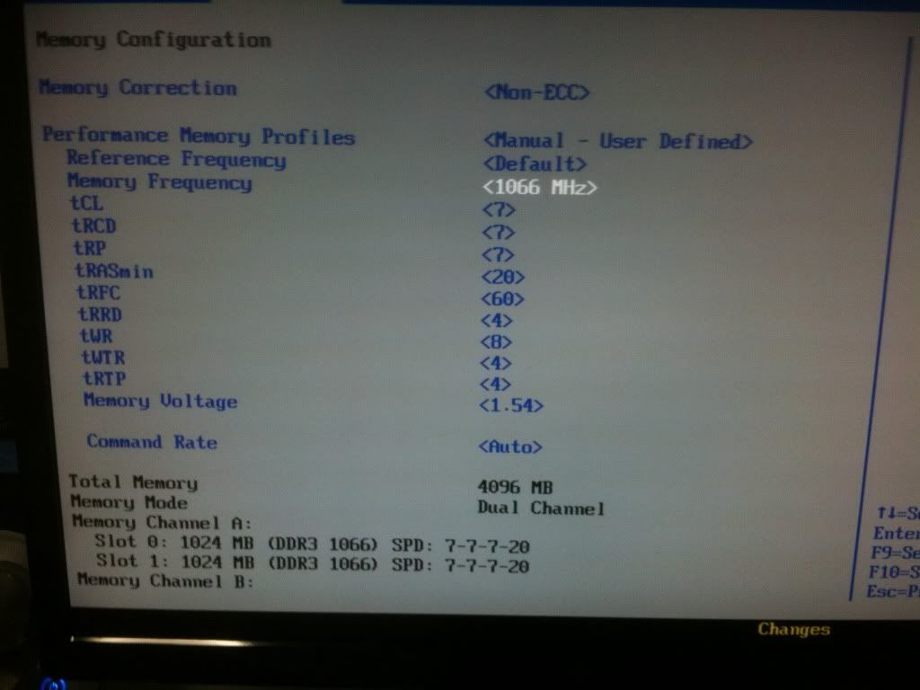

Hmmm , yes it's on SPD . But no matter what i do in the ram clock setting section it jsut resets , so any advice how to do the setting?
HOpe this maybe help me better
http://i137.photobucket.com/albums/q...0/IMG_0015.jpg
http://i137.photobucket.com/albums/q...0/IMG_0016.jpg

Hey B3nj1. I believe the problem could bw something else, looking at your BIOS pics. You have a Q6800 proc which, I'm not sure though and haven't checked yet, could have an FSB of 1066 also - please confirm. If that is the case you cannot go any further than that with your mem, that's an Intel constrain. Other board vendors go around this issue but not Intel. If this is so you can only oc your proc to get your mem faster.
The other possibility would be to force the mem freq to something else other than default or 1066, but I guess you have done that already.
Just looked at the first pic and in fact the proc is on an 1066 FSB (system bus speed). You're out of luck my friend. You can either get a new proc or underclock your current proc, if it's allowed to lower the multiplier so you can raise the FSB. With a chinese cooler I don't know. You must have an 11 multiplier, if you can set it to 9 and FSB 1333 you'll get 3GHz on your proc and mem at 1333, or maybe try higer even.

b3nj1, Sean posted a pretty good guide some pages back. You might want to read it as it has very helpfull information.
You will need to manually adjust the System Bus Speed (FSB) as well as you System Memory Speed. Keep them synched at 1333 or higher if possible.
You might have to up the proc voltage and maybe the FSB and NB voltage as well. Your mem voltage is quite low at 1.54V which is good, if it's the rated voltage you probably don't need to raise it. Just go step by step raising freq and when your system gets unstable raise voltages. Read Sean's guide, it explains this in detail, not sure what page it is in though, it's 88 pages to look for. Should be in the latest ones. Let us know how it goes. Good luck.
b3nj1, this is the "advanced" guide, this gets into GTL even and it's kinda only when you're an expert and really wanna push the envelope.
There is, I believe, an easier one before this one, posted long time ago.
Anyway, the process is the same, start raising FSB until voltages are not enough anymore, raise voltages a bit, repeat while voltages are safe. You can play it safe and only oc as far as your current voltage lets you go and don't overvolt.
This is a very simplistic aproach of course. You should have some margin at first so you can raise a bit at first, I guess if you go straight for 333 FSB you should manage to hold, try some stress test. If it's ok then start your way from there with smaller increments, like 5 or 10 MHz at a time a when you get to the limit try with even lower increments to reach the highest possible freq.
Go easy on it.
hey Manel , I Tired 333mhz and 300mhz at 9x mutiplier , however I was promt to revert back to bios to change setting as it failed for 333mhz , if i set it to 300mhz , i will be able to boot into window 7 loading screen but it hangs after awhile . so what does this means? My rams are still at 1066mhz though
I guess your proc can't handle 333 or 300 right out of the box then. You'll probably need to up the voltage a motch or so.
Have you tried to raise the freq just like 10MHz at a time and see where you get stable, without any voltage adjustments? Try that.
Also, when you adjust reference freq you need to also adjust mem freq since your're on manual now. Keep them in synch.
