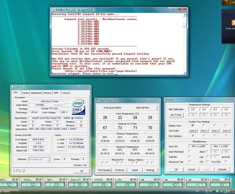

having trouble getting my system stable under Prime 95 it usually failed around the 1 hour mark however it is stable under linpack 10 pass.
any advice welcome
http://i18.photobucket.com/albums/b1...2262/q9650.jpgPHP Code:

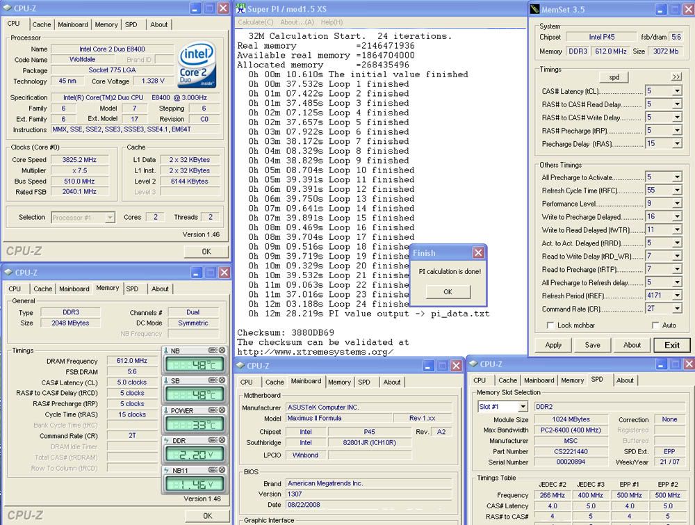

Just did 3 SPI32M runs with my M2F and Cellshock PC-8000 GKX sticks. This board has strange behaviour, it is most stable on the 5:6 divider. The times are bad as I had to run under 4GHz, PL8 (PL9 on first bench), Ai Clock Twister on moderate, and have static read and dram read training disabled. The GKX did ok, max SPI32M stable on 2.20v was 630 MHz.
510 FSB, 612 MHz, PL 9
http://i266.photobucket.com/albums/i...PL922vdimm.jpg

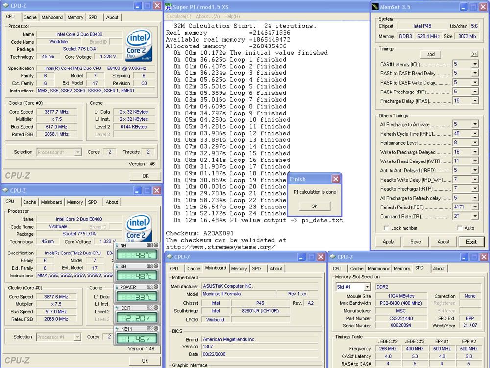

517 FSB, 620 MHz, PL 8
http://i266.photobucket.com/albums/i...PL822vdimm.jpg

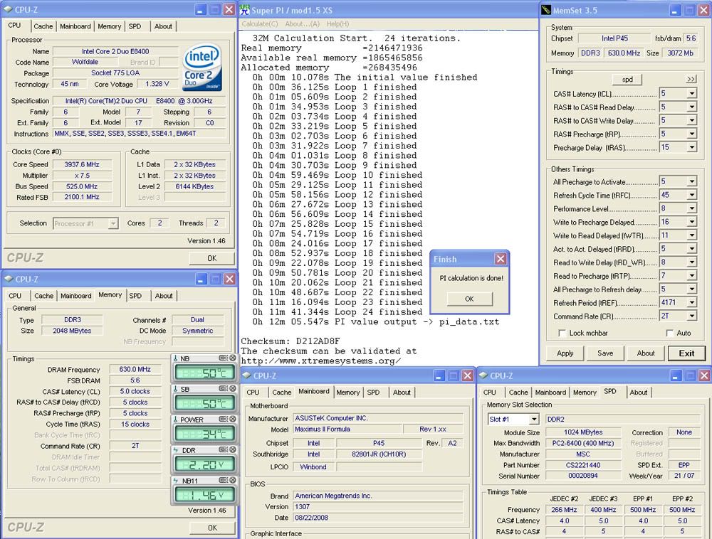

525 FSB, 630 MHz, PL 8
