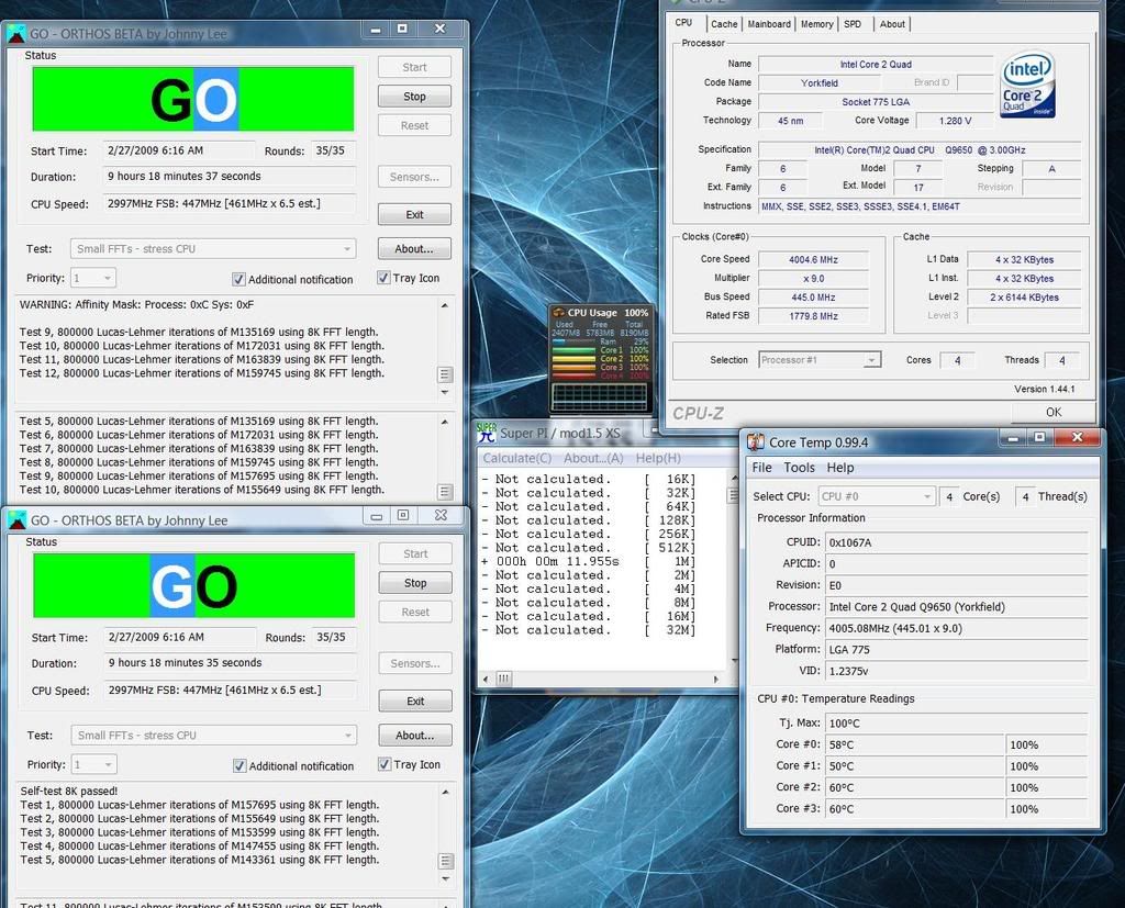

BIOS 1301
1. Noticed the FSBT(VTT) will default to 2.00v after Hard Reset/Reboot related to Crash/Freeze
2. 442FSB is fine, stable 100%...I move it to 444mhz and the System completely powers off....3 sec delay...and then powers up almost as if I changed dividers...even though all I did was move to 444mhz which pushed the Ram to 1066. Can anyone explain this? After the complete power off, it comes back unstable/freezes in prime/system.

4.0ghz is possible with this Gem of a Chip, but I agree about this Board being janky with 45nm Quads, I've seen "Machine Check Exception" BSOD a couple of times, never saw that with the Wolfdale.
What I didn't like were the voltage amounts needed to be stable at 4.0ghz vs. 3.9ghz at substantially lower voltage inputs.
4.0ghz - Damn close to Stable 444x9
Strap 333
CPU Voltage : 1.26875
CPU PLL Voltage : 1.5
North Bridge Voltage : 1.61
DRAM Voltage : 2.0
FSB Termination Voltage : 1.32
South Bridge Voltage : 1.050
Loadline Calibration : ENABLED
CPU GTL Reference : .63x
North Bridge GTL Reference : .67x
DDR2 Channel A REF Voltage : DDR2REF
DDR2 Channel B REF Voltage : DDR2REF
DDR2 Controller REF Voltage : DDR2REF
SB 1.5V Voltage : 1.5
3.9ghz Rock Solid 433x9
Strap 333
CPU Voltage : 1.2375
North Bridge Voltage : 1.55
DRAM Voltage : 2.0
FSB Termination Voltage : 1.2

Before I even get started, thanks to mikeyakame, I have a much better understanding of clock skews and their importance after reading his guide. Also, thanks to ericeod for pointing me in the direction of the read. One more thanks to Grnfinger for his input up until now. Along with the pencil mod, I'm going to try the 333mhz strap at 1080 and bump down the voltage of the nb.
Here's where things stand. I'll start with the BIOS settings and then I'll go into what's going on. (I've flashed to the Rampage Formula, 0802 Beta)
Extreme Tweaker
Ai Overclock Tuner : Manual
CPU Ratio Control : Manual
- Ratio CMOS Setting :9
FSB Frequency :445
FSB Strap to North Bridge :400
PCI-E Frequency:101
DRAM Frequency: DDR2-890
DRAM Command Rate :2N
DRAM CLK Skews all set to AUTO
DRAM Timing Control: Manual
CAS# Latency :5
RAS# to CAS# Delay :5
RAS# Precharge :5
RAS# ActivateTime :15
RAS# to RAS# Delay :Auto
Row Refresh Cycle Time :Auto
Write Recovery Time :Auto
Read to Precharge Time :Auto
Read to Write Delay (S/D) :Auto
Write to Read Delay (S) :Auto
Write to Read Delay (D) :Auto
Read to Read Delay (S) :Auto
Read to Read Delay (D) :Auto
Write to Write Delay (S) :Auto
Write to Write Delay (D) :Auto
Ai Clock Twister :Strong
Transaction Booster :Manual
Common Performance Level (10)
CPU Voltage :1.3625
CPU PLL Voltage :1.58
North Bridge Voltage :1.63
DRAM Voltage :1.92
FSB Termination Voltage :1.4
South Bridge Voltage :1.10
Loadline Calibration : Disabled
CPU GTL Reference :0.62x
North Bridge GTL Reference :0.67x
DDR2 Controller REF Voltage : (DDR2_REF)
SB 1.5V Voltage :1.6
CPU Clock Skew: (Delay 100Ps)
NB Clock Skew: Normal
NB LED Selection : NB Volt
SB LED Selection : SB Volt
CPU LED Selection : CPU VOlt
Voltiminder LED :Enabled
Advanced CPU Configuration
C1E Suppport : Disabled
CPU TM Function : Enabled
Vanderpool Technology : Enabled
Execute Disable Bit : Disabled
Max CPUID Value Limit : Disabled
USB Configuration
USB Functions: Enabled
Legacy USB Support : Disabled
I initially tried these exact settings at 450fsb and couldn't get into Windows. When I bumped it down to 445fsb, I booted into the OS successfully (let's hope 450fsb is a fence and not a wall). I expected errors pretty fast since with only 5mhz more I couldn't boot but I wound up running stable under load for 9 1/2 - 10 hours or so. I also ran SuperPi to 1M (its in the screenie, just under 12 seconds), ran Vantage, 3D06 and moved around about 100gb's of data - all without incident. Then I decided to try and image C just for shoots and haha's (good thing I have a clean image already).
This is when I got the hard lock-up. :(
I restarted and this time I got stuck at OS load (I think it was at the scrollbar). I restarted and upped vCore to 1.36875 (mind you how terrible vdroop is on this board, at 1.36250, I reported as low as 1.27 in the OS), still nothing, this time I got stuck at the logo screen. So I upped vCore again to 1.37500, still no boot, stuck at the splash screen.
A couple of things to note:
I've set vcore to 1.3625 in BIOS but it drops to as low as 1.27 in Windows (gotta love the droop on this board - I don't know why I haven't done the pencil mod - this is one of the first things I'm about to do). I had to disable LLC to get any stability, so no help there. Temps are between 51c-60c on max OrthosX2 load with affinity set appropriately. Stable at 100% load for almost 10 hours before the lockup.
NB set to 1.63 in BIOS and reports as 1.68 in Windows (I need a bunch because I'm running 8gb and I'm trying to find a 24/7 for my rig as is but that's a bit much); this also puts it right at 47c (above that temp AFAIK it starts to loose stability). I'm at 1:1 right now so ram is 890mhz and the Transaction Booster level is set at 10.
Vanderpool Technology is Enabled because I virtualize on this rig quite often and CPU TM is Enabled because I'm shooting for as high as possible vcore.
Here's a quick screen. Oh, and feedback is greatly appreciated at this point as I'm a bit confused by a few things. :welcome:
http://i237.photobucket.com/albums/f...k/FirstRun.jpg

Hi guys , need some help , i using E85 E0 + Maximus F X38 (VID: 1.25)
450X9
want to use this for 24/7
voltgens are safe ?? :shrug:
stable with 2hrs in Prime blend
CPU PLL worries me because droop , too much high ??
Code:Extreme Tweaker
OC From CPU Level Up : AUTO
- Ratio CMOS Setting : 9
FSB Frequency : 450
FSB Strap to North Bridge : 400
PCI-E Frequency: 100
DRAM Frequency: DDR2- 900
DRAM Command Rate : AUTO
CAS# Latency : 5
RAS# to CAS# Delay : 5
RAS# Precharge : 5
RAS# ActivateTime : 15
DRAM Static Read Control: ENABLE
Ai Clock Twister : AUTO
Transaction Booster : DISABLE [1]
CPU Voltage : 1.3 (real 1.28)
CPU PLL Voltage : 1.56
North Bridge Voltage : 1.35 (real 1.38)
DRAM Voltage : 2.02
FSB Termination Voltage : 1.36 (real 1.30)
CPU GTL Reference : 0,63
North Bridge GTL Reference : 0,63
Voltiminder LED :
CPU TM Function : Disabled
Vanderpool Technology : Disabled
