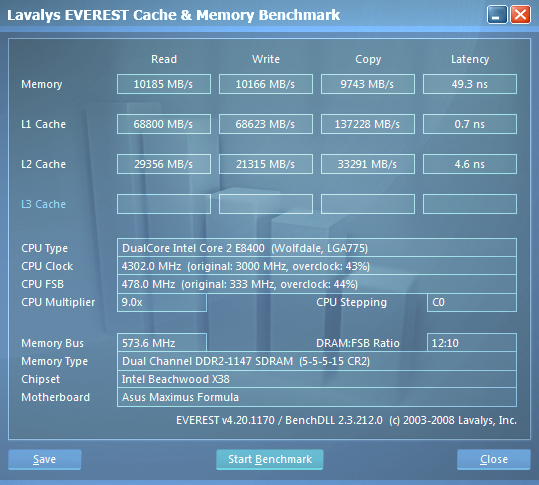

This is my 4.3GHz setting its 15hours prime stable, maybe it will help you.
Extreme Tweaker
Ai Overclock Tuner : Manual
OC From CPU Level Up : AUTO
CPU Ratio Control : Manual
- Ratio CMOS Setting : 9
FSB Frequency : 478
PCI-E Frequency: 110
DRAM Frequency: DDR2-1147
DRAM Command Rate : 2T
DRAM Timing Control: Manual
CAS# Latency : 5
RAS# to CAS# Delay : 5
RAS# Precharge : 5
RAS# ActivateTime : 15
RAS# to RAS# Delay : 3
Row Refresh Cycle Time : 42
Write Recovery Time : 6
Read to Precharge Time : 3
Read to Write Delay (S/D) : 8
Write to Read Delay (S) : 3
Write to Read Delay (D) : 5
Read to Read Delay (S) : 4
Read to Read Delay (D) : 6
Write to Write Delay (S) : 4
Write to Write Delay (D) : 6
Ai Clock Twister : Strong
Transaction Booster : Disabled
RELAX LEVEL:0
CPU Voltage : 1.38
CPU PLL Voltage : AUTO
North Bridge Voltage : 1.49
DRAM Voltage : 2.16
FSB Termination Voltage : 1.40
South Bridge Voltage : 1.050
Loadline Calibration : Enabled
CPU GTL Reference : 0.63X
North Bridge GTL Reference : 0.67X
DDR2 Channel A REF Voltage : DDR2
DDR2 Channel B REF Voltage : DDR2
DDR2 Controller REF Voltage : DDR2-REFF
SB 1.5V Voltage : 1.5

http://i237.photobucket.com/albums/f..._1147_4300.png
Going to run a few benches and give it a run on Fall of Liberty ans see how it performs.
