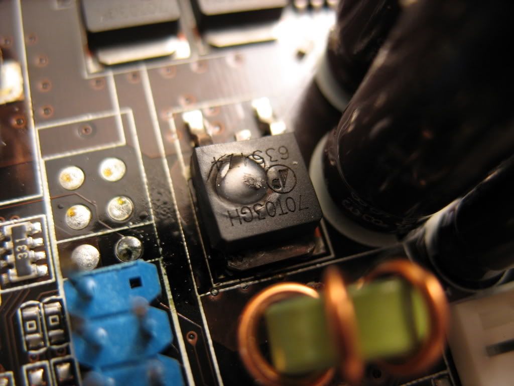

The same happened to me, except one of the other mosfet close to that one burned up. Just RMA it.Quote:
Originally Posted by Jodiuh
http://www.xtremesystems.org/forums/...d.php?t=112219

that looks nastyQuote:
how did it happen
