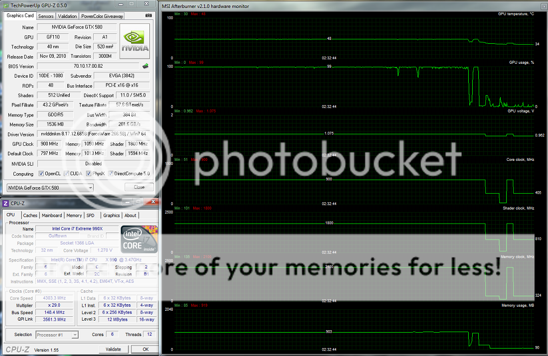

Originally Posted by
p3gaz_001
usually if driver reset is like the voltage is not enough, but some times it does the same when memory speed doesnt match with the gpu speed.
1.012vid is a good vid, you sould be able to get 950mhz with 1.138, this on stock cooling,but you have to try step by step, first of all push to the max your gpu with stock voltage,(vantage ppu on loops, 3dm011 loops, heaven 2.1/2.5 loops OCCT GPU/MEM tool .. & so on) when u found that,start rising up the gpu speed until you get the max speed with max voltage,with an eye on temps, but be sure to match gpu speed with a correct memory speed.
