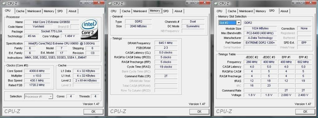

I am at 3.4 with a e6600(planing to upgrade to a qx9550 sometime in the near future) and i have hit a wall and cant get it to be stable after this.
My bios settings are as follows:

http://i207.photobucket.com/albums/b...QX9650OCEG.jpg
RAM is set @ 2.3v with a corsair RAM cooler modded with San Aces :)
Pushed it higher but no screenshots of ity atm. Just killed my windows install trying to get 435 x 10 to boot again :rofl:

Another basic reason you can get "DET RAM" error is because the set value for your memory voltage is set too low.
Case in point my memory modules have a EPP for 1200mhz@2.2volts + timings, however if I try to run all for sticks at the lowest JEDEC value of 800mhz@1.8 it wont boot with all for sticks installed, it will boot with tow DIMs installed but at that voltage but not all four.
