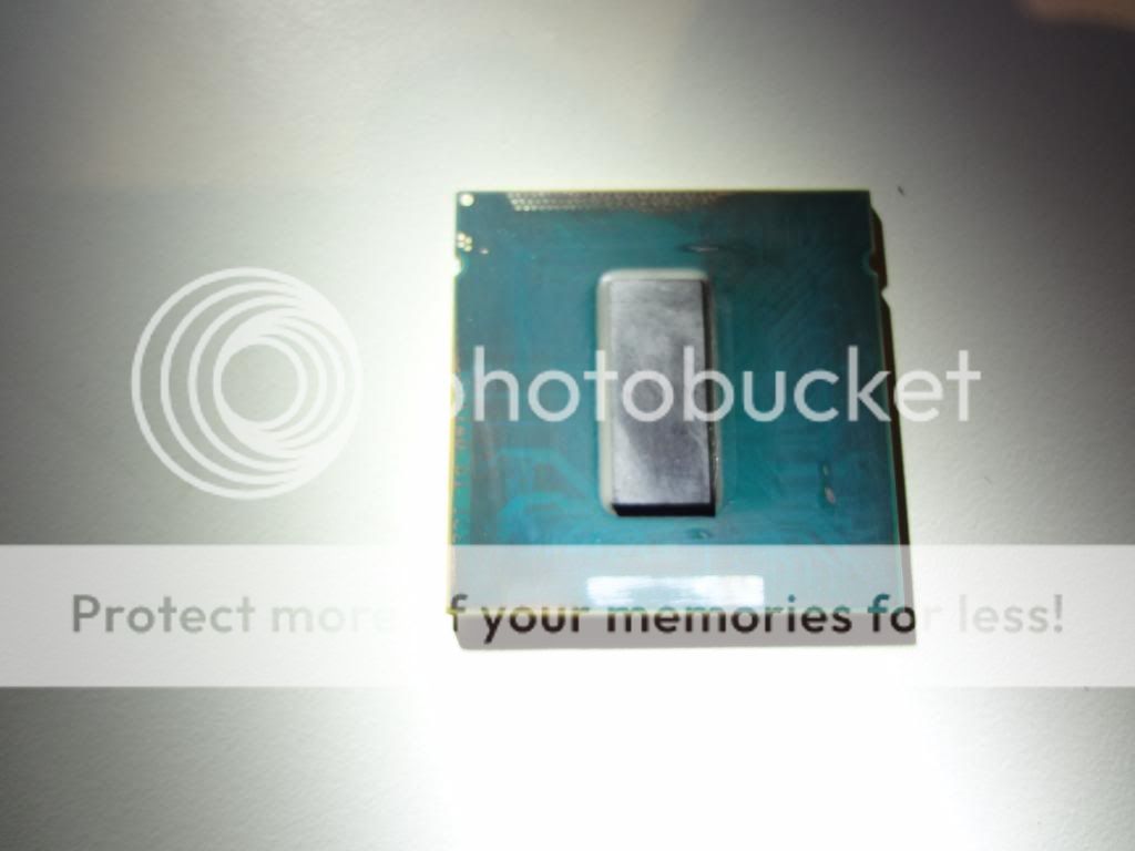

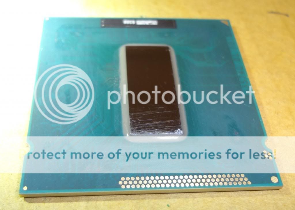

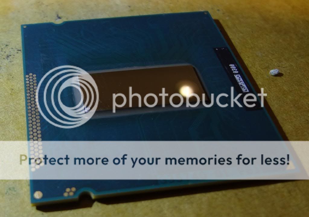

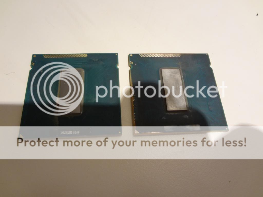

Just Unlidded and what a difference in temps and stability , Im so impressed i decided to start my clocking from beginning again and see how low i can drop Vcore and temps with a set of 2133 memory and once I hit bottom Ill work back up to a good power to heat ratio . So far everything has been successful with a 25c drop in celcuis in prime of 3 hours and IBT passed. I was able to get IHS off with out a scratch and my top was a hella tight from my water block . but was well worth the drop in temps and vcore I'm achieving , its killing my best sandy s by a lot . Right now I'm priming as Im doing this 4.7 @ 1.330 Vcore
Top Block: Phobya HeGrease Extreme Thermal Paste
Under Top: Coollaboratory Liquid Ultra Paste
http://i84.photobucket.com/albums/k7...0kUnlidded.jpg
http://i84.photobucket.com/albums/k7...kUnlidded1.jpg
http://i84.photobucket.com/albums/k7...kUnlidded2.jpg
http://i84.photobucket.com/albums/k7...me1330pass.png
http://i84.photobucket.com/albums/k7...ed1330pass.png

Carelessness killed a 3770K today.
I was expecting the black gunk holding on the IHS to be tough to cut through; on my CPU it was not. The blade went right through and nicked the corner of the die pretty good. Stupidly I never tested the CPU before removing the IHS, but i'm pretty positive this 3770K is dead. From NiB to killed in under 5 minutes.
Be careful when starting to cut into the corner of the black adhesive, it might not be as tough as expected:
http://i399.photobucket.com/albums/p...ps7ccd36c6.jpg
http://i399.photobucket.com/albums/p...ps1cda37af.jpg
Yes I have done that, makes a rather expensive key chain. Take your time or pay the price.
I have one chip like this, it's still working fine
http://i458.photobucket.com/albums/q...4/06473f8c.jpg
I'm now the shameful owner of 2 killed 3770k's; I give up.
trn: two in row? what happened in 2nd round?
2nd CPU is on the right, 1st is on the left.
I'm not really sure. I was rough with the brillo-pad when removing the left over black IHS-adhesive; I might have damaged something then. There is also one tiny area on the upper left where the green coating is all worn off and copper is showing, I don't see damage to the copper though. I tried re-mounting this about half a dozen times and still no luck.
http://i399.photobucket.com/albums/p...ps2fda105d.jpg
http://i399.photobucket.com/albums/p...ps0182b73e.jpg
http://i399.photobucket.com/albums/p...ps41cdc7a9.jpg
mate, saw those at ocn too...why would you LAP your die and pcb like that???
Next time use your fingernails for removing the glue.
A Brillo pad? Why on earth did you use that? Fingernails or a creditcard are enough to remove the glue.
I use to use Brillo to remove all matter of crud off Copper/Stainless/Iron plate when I was young. Now using a Brillo for an Intel cpu, isn't that kind of going over the top?
I would use a dab of Mineral Turps to loosen the black-glue/sealant and then clean it all up with Alcohol. Is there any other way to clean the pcb other than scratching it with any object, ie, like your finger?
Doing it just with your fingernail or a creditcard is easy enough. It's not like you have to rub for hours. Got it done in less than 5 minutes. I'd rather not use any dissolvents on the pcb if i can do without.
