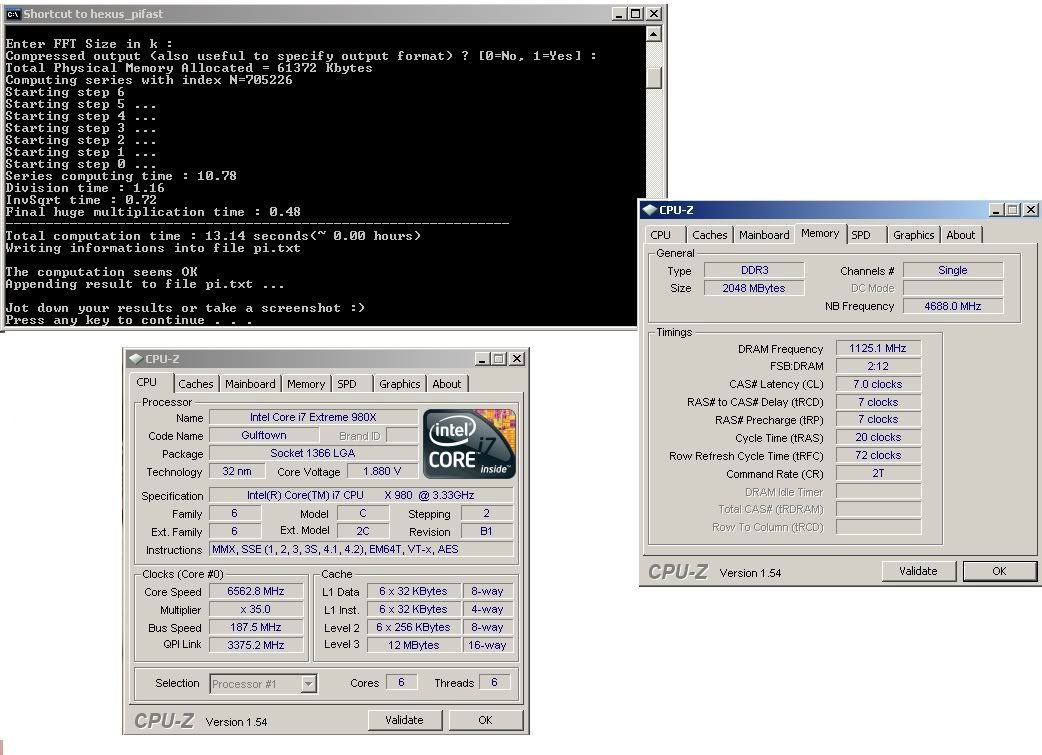

I did this one tonight with the mem at only 1.76v on LN2.. It was actually an accident.. :D Meant to set the voltage to 1.80 - 1.85v but it actually does'nt seem to matter with great mem and a great cpu.. cheers!!

he said nitro "I did this one tonight with the mem at only 1.76v on LN2"
or i can simply just wait a few weeks and get a full 6 stick kit for 12gb and have it fully stable at CL8, 2000mhz, 1.65v and around 1.25-1.3v qpi and not have to fine tune as much... the kit has already been tested according to the email i got from GEIL on the RE3. so it's not a big deal to just wait a bit... 1600 @ CL7 isn't bad in the mean time.
his ram is on air (cmgtx2), cpu on ln2 :)

I meant what Splave said.. Cpu on LN2 / Ram on air. only 1.76v for the mem.. Thanks so much Shadewither and skuldarin!! :D
Splave, How is the cpu intel sent. I hav'nt noticed much of a hit using single channel and xp 32bit.. I did notice that there's a big difference in win 7 though..
