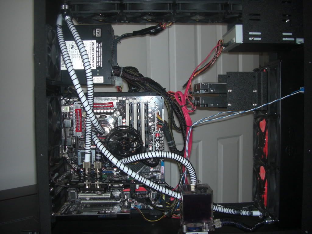

I used to have High Load Temps on my 920
Till I got a Heat tamer!
http://www.xtremesystems.org/forums/...202620&page=22
http://i293.photobucket.com/albums/m...1/CIMG0789.jpg
